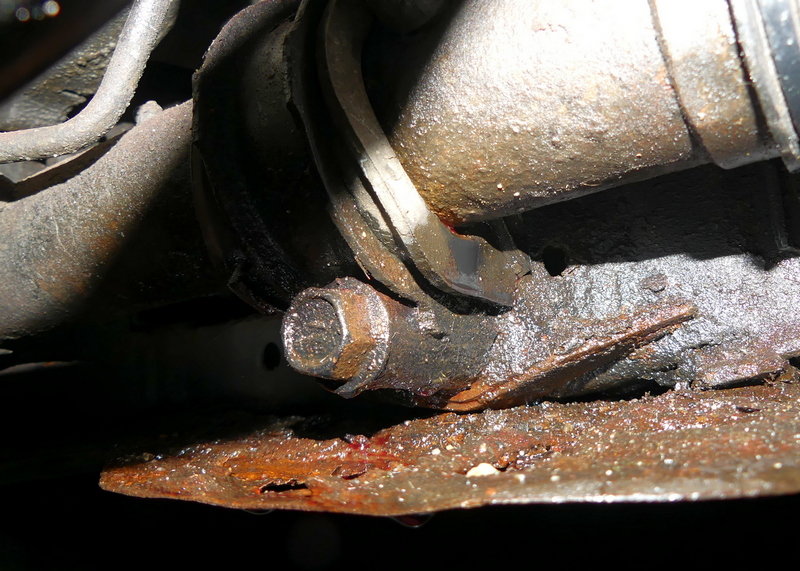

    The boot is fine & where it pulls over the rack looks clean. & the inner tie rod didn't have any atf on it. It seems to be coming out around the clamp/bushing? I'm wondering if I'll find it's rusted under the bushing.

    Sounds like it's still coming from the seals then...any fluid at all around the tie rod boot is coming from the rack unless it's something other than ATF that somehow ended up there
    Got a pic?

    & it seems to be coming on fast. By that I mean things seemed ok. Well, had the steering noise from this thread, which was curious & needing investigating, however there was no leakage or any other symptoms. Monday night I did a couple of errands & as I left the last one it started whirring/wining & by the time I got back to home base, about 2 miles, it was hurting & had started leaking. Today I could feel some vibing through the floorboards. Just sayin' that while I'm not sure it's this way all the time, if you think it's coming down the pike, might be a good thing to have parts in hand. Look for a deal, maybe a rebate thing.... my 16 cents again....
    I'll go see if I can snag a pic.... Might take me a few....

    Think that's the problem peakin' out the bottom of the bushing?

    Well that rack bushing has seen better days and probably needs replaced (should do all 3 when you do)... But that does look like ATF around it to me so you could very well have a rack leak going on. Seems like an odd place for it to leak though unless the rack itself is cracked under the bushing maybe?

    That's my guess. I just started watching the timmy vid. The how to plus what extras I'll need. Had to stop for a minute cuz I realized that the rack comes with inner tie rods, which I just wasted 130.00 on. Ok. just had to whine a minute....
