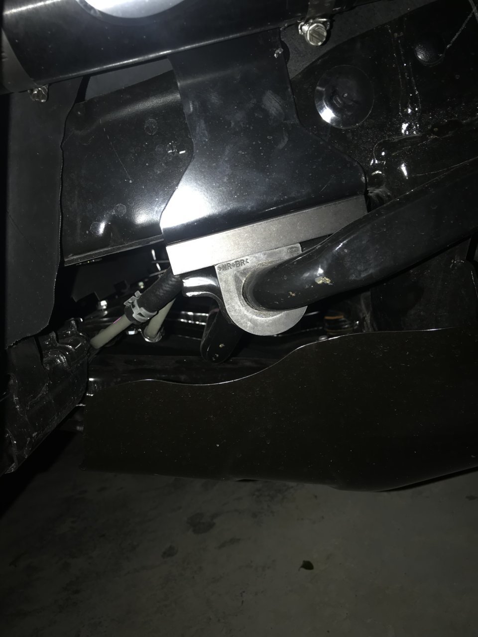

    Just not sure how you can mess up that relocation bracket?? I checked it out.. it’s a 1” black aluminum block and resi bracket is above it.. I’d love it to be something that simple.. the squeaking (passenger side) went away this morning because everything was wet with dew.. now that grinding popping sound has progressed.. has me thinking it might be the spider gear mashing the needle bearing in the diff..

    957F4024-2F86-4386-BFD1-06C4CC9F8393.jpgrelocation bracket
    Synergy001[QUOTED] and tcjacado like this.

  17. Mar 5, 2019 at 10:19 AM
    #37
    Fluffymonkey
    Fluffymonkey Token
    Jul 14, 2008
    #7932
    2,984
    College Station, TX
    2013 Trd Sport DC, 07 DC sr5, 03 Prerunner
    2003: Stock 2007: Avid Offroad sliders, 30% front tint, bed mat, Truxedo low-pro qt tonneu cover, aero turbine 2525 muffler w/ 8'' tip, AR25 Resonator, 16x8 Dick Cepek DC-1 w/ 265/75 Goodyear Wrangler Duratracs, 2010 headlights, ome 884 coils with .5'' top plate spacer, OME sport front shocks, bilsten 5100s rear, 2'' aal, locking gas cap, LR ucas, Viper 2-way remote start, afe drop in filter, Rocky locking bike mounts, gear chest, scangauge, pop n lock tailgate lock 2013: most things transferred over from my 07, 5100s @ .85 + eibachs and Toytec tps for 3'' front lift, wheelers progressive aal w/ overload; compustar 2-way remote start; Antennex shorty antenna, pop n lock tailgate lock with programmable key, seat covers, Toyota's crappy all-weather floor mats (should have got Husky's or Weathertechs), TRD skid plate, led light pods mounted in front bumper valence w/ Eyourlife wireless harness and remote, led bed lights, light pods mounted in bed, Devil Horns emblem from Diaz Fabrications, rear facing pod lights in bed, under seat lights,
    I had a similar sound (maybe less grindy and more jangly) a number of years back after a lift. I crawled underneath and it turned out the shop forgot to torque down the sway bar end links as they were no more than finger tight.
    whatstcp, Hookedup[OP] and DIRTT_Fish like this.
