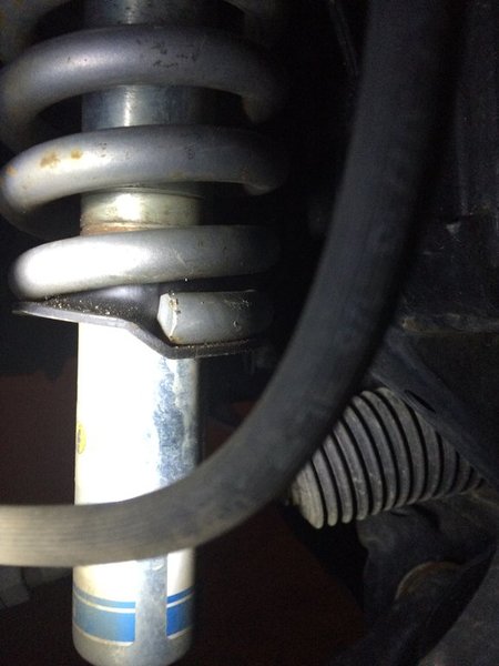

    Update 2:Fixed now. It was the top hat spacer on the coilover. Not LCA bushing. I replaced the whole LCA a couple years ago and it did nothing.
    Update: After removing and re-assembling the strut, I can confirm this is not the problem. It made a temporary improvement that lasted for about a week and is now getting worse. I'm leaning toward LCA bushings now.
    So I finally confirmed it is in fact the coil making the noise! I was jacking it up this weekend and it made the noise while it was lifting. I placed my hand on the coil and felt it move when it made the noise.
    Now the question is why is it making noise? And what do I do to stop it?
    My guess is that the coil is rotated ever so slightly too much or too little on the perch and as the coil compresses/decompresses it is moves and creates a poping sound. I will have to take the whole strut off and compress the coil to fix it. Is there an ideal position for the coil to sit on the perch? Would it help/hurt to put a piece of rubber on the perch before setting the coil again?

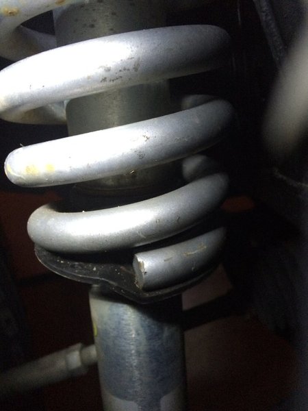

    I took a couple pics of the coil on the perch as it sits now.

    Just use the easy method of separating the spring from the strut. You won't even have to completely remove the strut assembly using this method to fix your problem. This method is widely used and many agree it's safer than using a cheap spring compressor. I've done this many times and it's quick and easy.

    Thanks for the video! I would love to try this but I'm hesitant to remove that top nut. There was something wrong with the threads on either the shaft or the nut and it was a nightmare to get on. Had to keep tightening and loosening it repeatedly to get it to go on. I think there was some burring on shaft threads.
    I'm considering just buying a new shock and rebuilding the whole assembly. Other option is to just use compressors on the coil to get enough play to re-seat it. Either way I will unfortunately need to pull the whole assembly out.

    Jack the truck up on that corner. Put spring compressor on spring. Lower corner to full droop. walla, free spring, then you can reseat it. without having to take anything more off than the wheel.

    We think alike! I tried that last weekend... The spring pretty much needs to be a full droop to have enough space in between the coils to get the compressor on but then the UCA gets in the way. And the strut mount covers the back half where the UCA isn't. Just my luck!
    I don't mind (much) taking the strut right off... I just want to make 100% sure I fix the problem before re-installing it again.

    I finally got around to taking the strut off and re-seating the coil. It took a while to find spring compressors that would fit and work! The top didn't show any signs of where or anything. The rubber was in good shape and there was no wear spots in the metal. The bottom perch however did have a small shiny wear spot right where the corner of the end of the coil sat. I think that was my problem area!
    When I re-assembled the strut, I made sure the end of the coil at the bottom was further away from the slope on the perch. I also twisted the coil so that the end of the coil at the top was not near any of the top plate bolts. Also, when I took the strut off I noticed that the top plate was not perfectly lined up with the bottom mount on the shock body. So when it was installed on the truck, the whole assembly was slightly twisted. I made sure that those were in line when reassembling.
    After driving around a couple of days, the noise has definitely gotten better but I am still hearing the noise on some bumps/dips. But I need to hit them a lot harder now for it to happen. I think that the bottom of the coil is still moving a bit on the perch. I wasn't able to compress the coil enough to get in there and properly clean away the dirt/rust so that's likely why i'm still getting movement.
    I'm just going to have to live with the noise for the time being. At least it is better now and i know now that it isn't anything that will get worse and cause bigger problems (knock on wood). The next time that strut comes out it will be to replace them with Fox adjustable coil overs!
