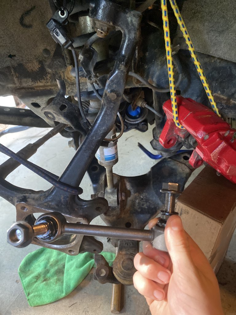

    I’m assuming this is not correct as the rubber grommet is cracked and appears to be leaking grease. Just not sure what this support bar is called. Anyone know?

    Sway Bar End Link

    Should I replace them with OEM or another brand? These lasted almost 90k

    I'm not paying $110+ each for OEM.
    I'll take the Mevotech for $25 each.
    As for what you should do? That is up to you.
    You can pick from $9.00 Ultra-Power to OEM at $110.00 each.

    I wouldn't be afraid of aftermarket on that part.

    Just replaced mine after 3 years of ripped boots. Got a cheap pair off of rock auto, easy simple quick fix.

    I just got moog greaseable ones. I can buy like 9 pairs of moogs before I reach the cost of OEM :rofl:
    Originals were all loosey goosey so I’m hoping the new ones tighten up the feel, paired with poly sway bar bushings.

    My ahead and bought the Moog with grease fittings. Do they come already packed with grease or am I to fill them up? Thanks

    I filled mine cause I couldn’t tell. I don’t think they did because new grease is what came out of the front of the boot when they were full.
    Takes like two pumps.
