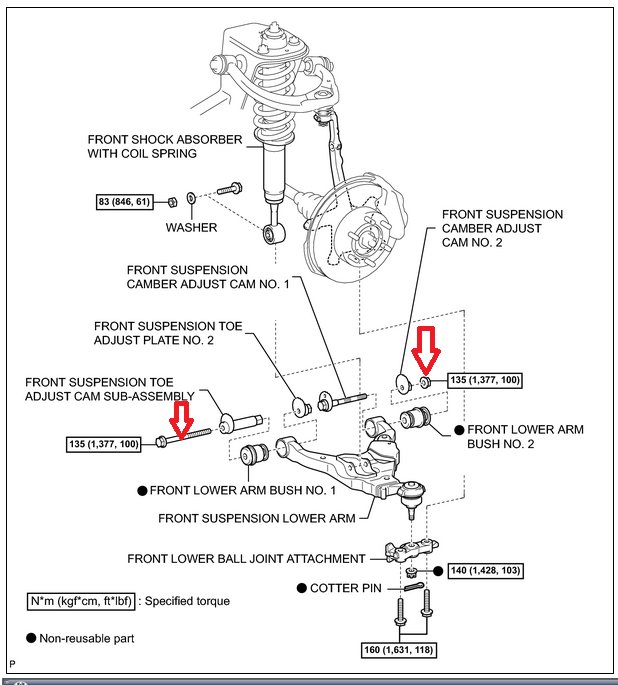

    I would bet good money its the lower control arm cam bolts... mine I have to torque higher than factory spec otherwise they will pop... sometimes when turning, backing up or going over bumps. I think the factory torque is around 85ftlb i have to go around 100ftlb. I only had to start doing this after my lift.

    What did you torque them to? I know factory is 155, correct me if I'm wrong
  10. Nov 2, 2019 at 2:06 PM
    super_white
    super_white Well-Known Member
    Feb 6, 2012
    #72230
    8,565
    Harry
    Connecticut
    2012 Tacoma 4X4
    Factory is 100 ft. lbs.
  11. Nov 2, 2019 at 2:08 PM
    Solution.45
    Solution.45 [OP] Well-Known Member
    May 31, 2011
    #57544
    325
    Chase
    Redding CA
    2011 White 4x4 double Cab
    100! Thanks buddy

    I believe the LCA bolts need to be tightened when the truck is on the ground and not on a lift. 100 foot pound's is the correct torque. Before tightening bounce the front end up and down. On mine I bounced the truck on the shallow ditch in front of my driveway as I can't budge it otherwise. I had marked all the cam washers first and none moved after bouncing.

    Make sure you torque the correct nut/bolt.
