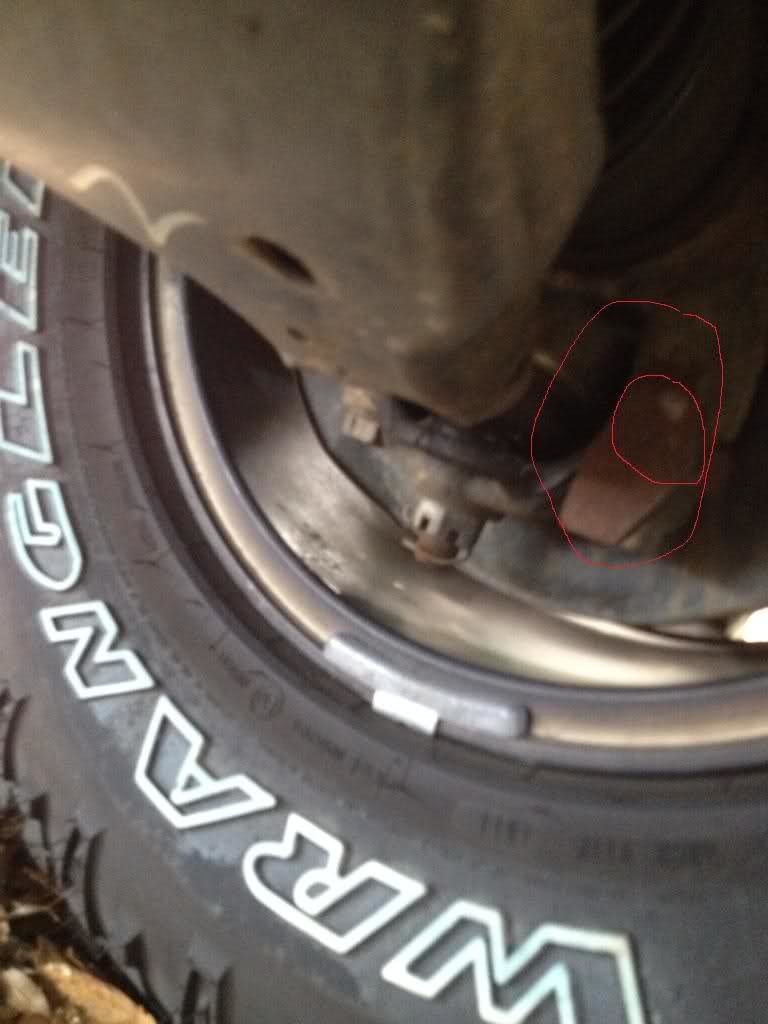

    It's the steering stop, I was having the same noise.. So I put some grease on the steering stop and it went away.

    Not my picture Used this for another thread:
    The big red circle is the actual steering stop, and the smaller circle is what rubbing together thus causing the sound.

    Where is the steering stop? Is it that piece of metal that is slightly concave mounted low and forward of the rest of the UCA, knuckle, etc?
    Did you get it when you were not turning? I'm getting it just going straight and turning. I can only detect it at slow speeds (less than 10-15 mph).

    I do not get it going straight, I did get it when I was turning out of my driveway. Now, if you are getting it while driving straight, I have no clue what could cause it... But I do know what's causing the popping noise while turning.

    Steering stop won't rub anything if you're going strait, only if you're at full turn you'll hear it. You have an OME lift, did you get the trim packers with it as well? They are small top plates. Whether you did or you didn't, I can almost garuntee that it's your sway bar contacting your shock. If you look from under the front, you will see that the sway bar comes very close to the shock and the spring cup. When your sunspension shifts, the curved portion of the sway bar may come in contact with that area. A few web sites offer a sway bar relocate bracket to remedy this problem. I believe Toy Tec is one of them. I put an OME lift exactly the same as yours on some one elses truck, and this is what it was. Hope this helps.

    I put it on the actual steering stop just enough to cover it. (picture above, the smaller circle)

    Just every time you grease your U joints, wipe the excess grease off of them and put it on those contact points. Supposed to do it every oil change or when you go through low water crossings.
