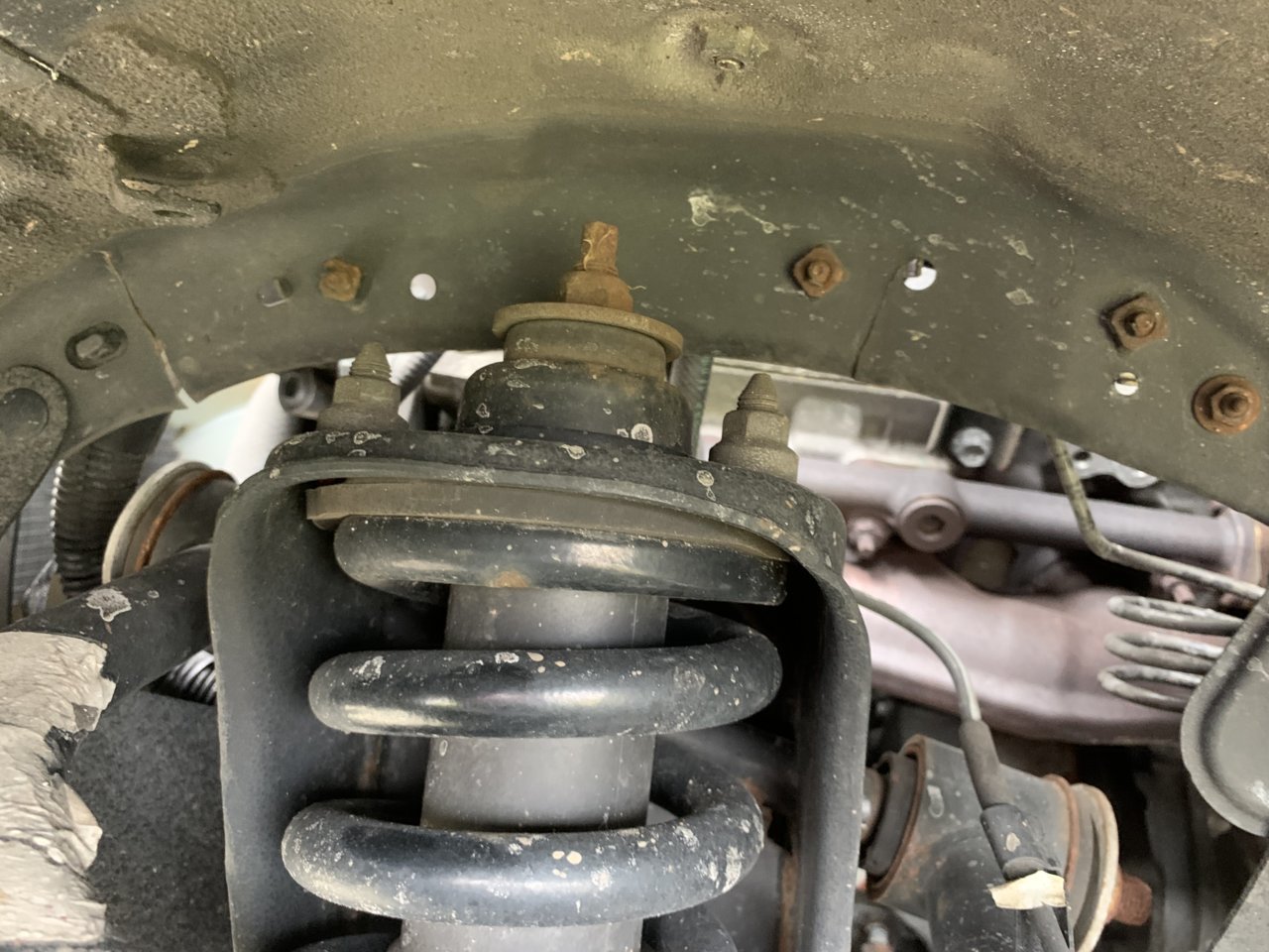

    Trying to track down a front end rattle (I think) on a 2015 DCLB. It started about one month ago out of the blue, not after a collision or anything. I initially thought it was under the dash, had it torn apart for awhile but can't find anything loose. It happens mainly whenever the left wheel hits bumps, and seems worse when the road is uneven. It happens whether I'm braking or not, whether it's in 4H/4L, and if I engage the e brake a notch or two it still does it. I can't feel anything through the steering wheel, but when it's really bad it feels like something is tapping the floor? Gonna attach some vids, hopefully someone has a suggestion, thanks for reading.

    on another note looks like your tire is possible rubbing the UCA area #2 vid

    Welcome. That sounds bad. Have you tried jacking the truck up and hitting the tire with a hammer to duplicate the noise? Maybe loose/worn sway bar links? Tie rod ends? When it’s off the ground, check the steering for play/looseness. I’m interested to know what’s making this noise.

    Haven't had it in the air and hit the tire, will do that now. I've tightened all I can and hit everything that looks like it the culprit but I can't duplicate the noise. I need to fix it obviously but in person it has more of a skidplate/dustshield sound more than something really substantial. So I'm worried, but I don't think its gonna drop a where or anything. Famous last words.

    Check your rack and pinion and the rack and pinion bushings. It took me months to figure out that was the culprit. Take your skid plate off and check and see if there is play in the bushings.

    Get the front in the air and hit your sway bar, tie rods, end links, control arm bushings, etc. with a deadblow and see if there is any play. It sounds like it may be emanating from the rack though.
