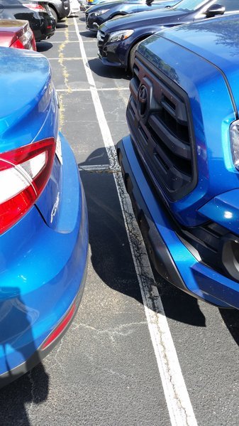

    No adjustment or fine tune on this/my system. I can get pretty close though before the tone changes from beeping to solid. This is how close I got to a focus at work before the tone went solid. I can role forward a little from here knowing I have about 8-10 inches left. As for turning in a parking spot, you can move the outside sensors closer to the edges and place them in the bumper shell. I did not want to do this because I didn't want to drill through paint. Here is another picture showing my estimates on where the sensors pick up in my setup and the strength levels. I'm basing these estimates off walking in front of the truck an taking note of where the signal seems to pick up and start beeping. It is solid when its green, yellow is a good steady beep, and red is a spaced intermittent beep. This is a 2015 Tacoma in the picture but y'all can get the picture lol. Side note, I could not see the trunk of the focus out the front windshield parking this close to it.

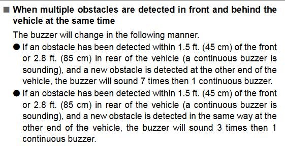

    On a related note, the manual mentions detecting objects in front of the truck. How?
  14. Feb 4, 2017 at 12:20 AM
    #34
    xTacoma16x
    xTacoma16x Well-Known Member
    Dec 10, 2015
    #171934
    227
    TRD sport 2016
    It's ok, once you learn how it's sensing objects in front of you. If it's wooden fence or empty plastic trash can, it will give you long beep within 2-3" but if it's parked car you get long beep at 12-15" and if it's utility truck with all metal bumpers you'll get long beep at 24" approx* so it measures density of the object and beeps at you accordingly.

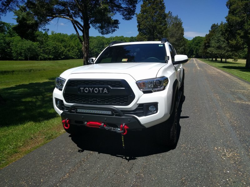

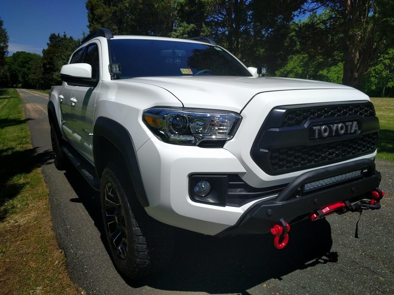

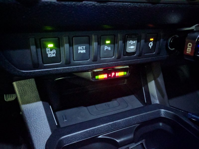

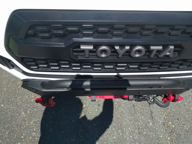

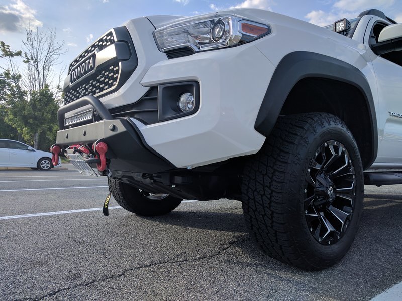

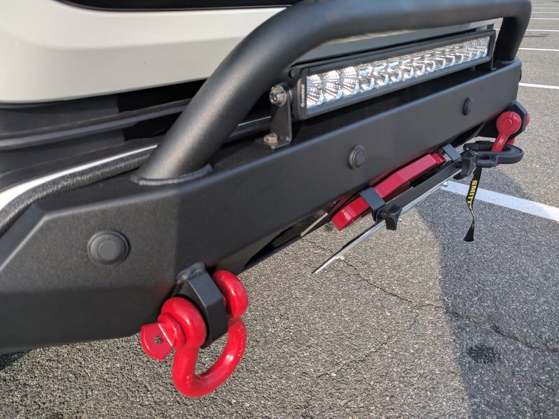

    My Rostra Parking Sonar with SSO Hybrid Bumper...
  16. Jun 4, 2017 at 6:01 PM
    #36
    Kennedyusmc
    Kennedyusmc Well-Known Member
    Sep 10, 2016
    #196950
    1,589
    Christopher
    2017 Cement Pro
    Still waiting for it
    ? Any pics or details?

    I like the location of the warning "box". That was the part I couldn't figure out, I don't like dash cluster option shown in the Youtube video. I'm putting mine there when I install my SSO on next weekend. Thanks for sharing!:thumbsup:
  19. Jun 4, 2017 at 6:31 PM
    #39
    amontances
    amontances Well-Known Member
    Dec 27, 2016
    #205842
    117
    2017 White Tacoma OR
    TRD Pipes | 18" Fuel Assault | Roof Rack | Tint | Steps | Husky Floor Liners | Bed Liner | LED Interior Lights | Swing Arm Bed Storage |
    i use velrco to stick it up there. make sure the surface area is super clean for it to stick. i also used one of those super industrial type velcro.
