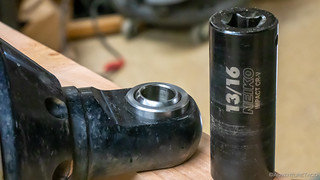

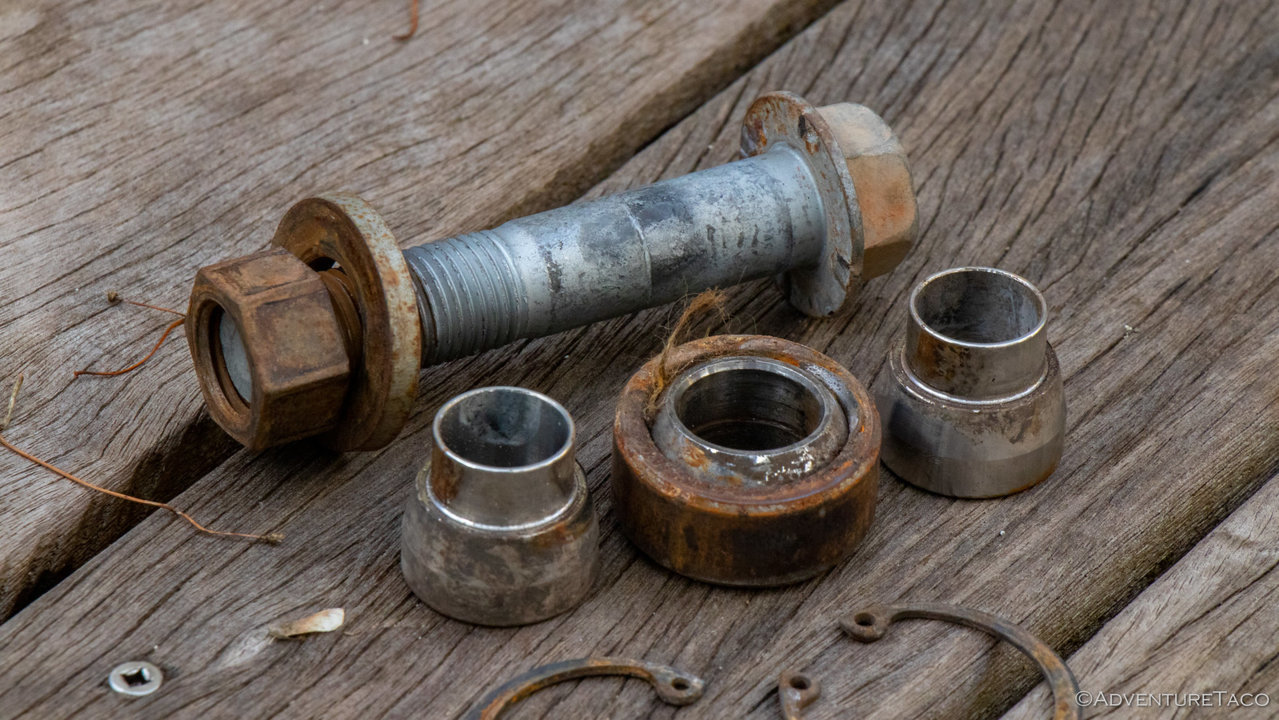

    After pinpointing the sound, I examined the lower spherical bearing on my driver side. It looked worse than this photo (borrowed from google)8D123E70-5632-43A2-A011-FBD083B504E1.jpg
    This is what is should look like
    I soaked the bearing with some pb blaster. I was able to clean most of the rust out and use a ton of grease. So far, the squeak is gone but I don't imagine for long.

    You left the bearing in the shock body and was able to clean it up to that pic?
    Looks pretty good.

    No lol, both pics are from Google. I forgot to snap some pictures. It doesn't look too bad though
