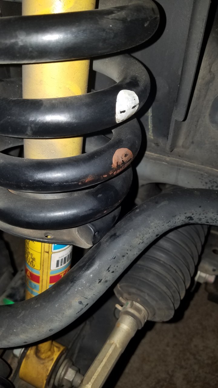

    This thread is old, but I found it and maybe someone else will. I just put a 2" leveling kit on my 2014 trd and it started squeaking going over small bumps in the road. I thought it was ball joints at first, after continuing to look and search I seen this. Sway bar actually touching my coil spring. Wheels are turned to the right for picture.

    Need to install sway bar relocation mounts. Simple fix

    Check if the swaybar is rubbing on the coilover parts...if so shim it out with a swaybar relocation kit from ToyTec or others...
