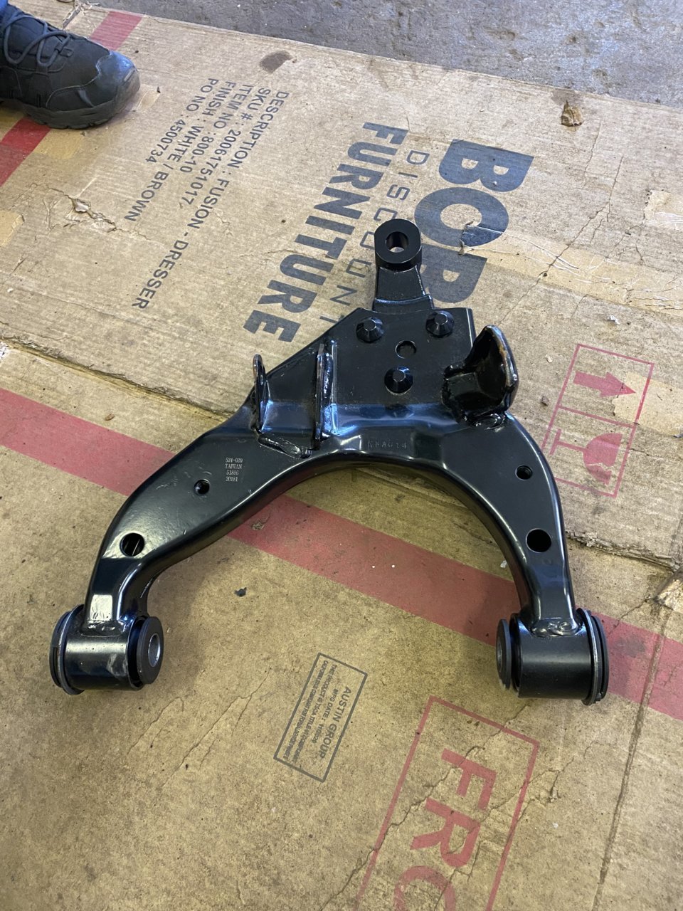

    What did you replace those parts with?

    Tuff Country Shocks, OEM springs (mine was gone) , I have the tundra 13WL setup, Energy suspension sway bar links and bushings "RED" , Moog end links, detriot axel lower control arms, inner , outer, TRQ rack,

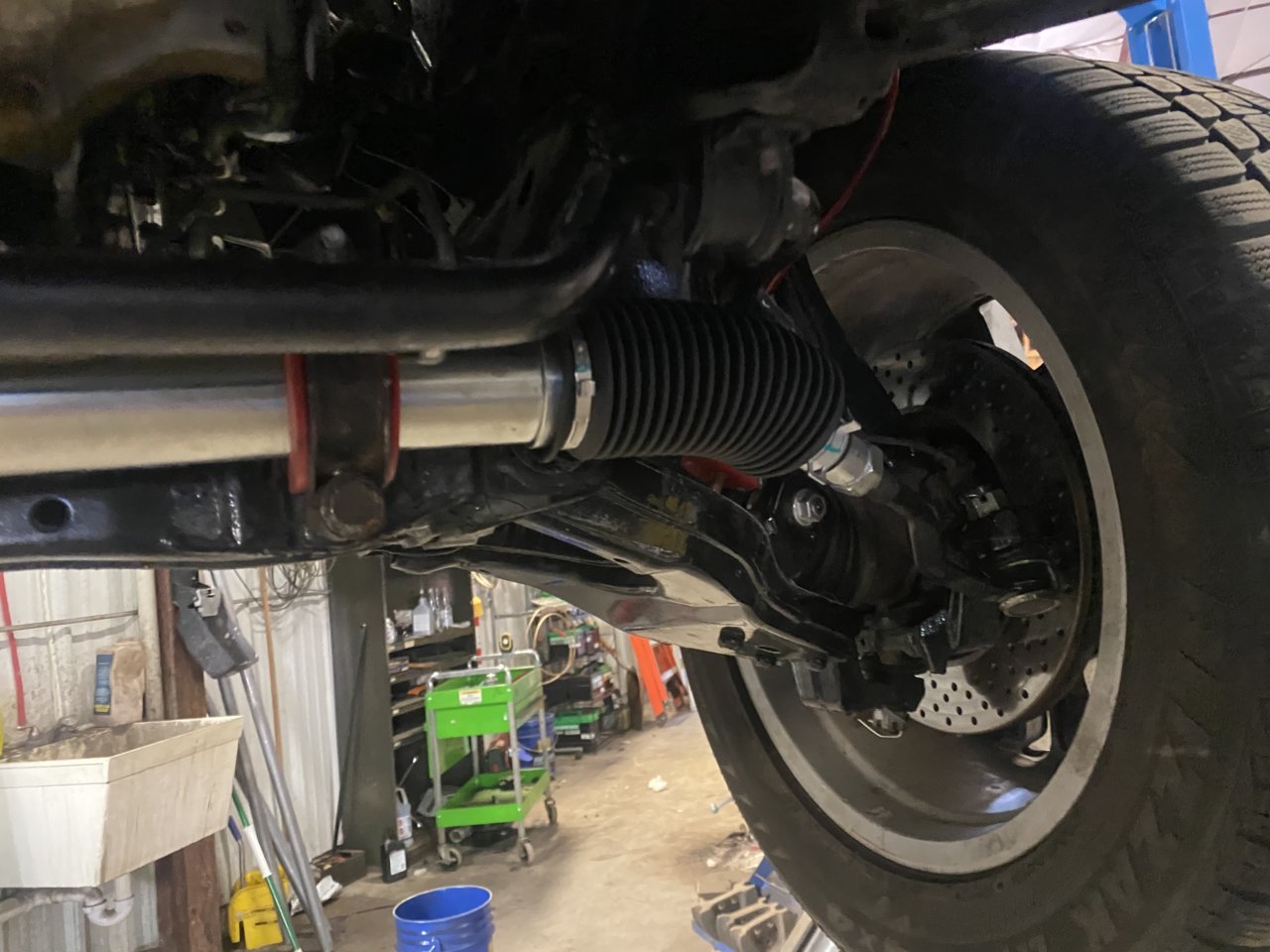

    I just noticed something from the picture? He did not replaced the driver side bushing for the rack mounts, could that be my problem?

    Extremely unlikely. It's probably more to do with the quality of the bushings in the new upper and lower arms, the tuff country shocks, and tire pressure.

    UCA are OEM , but the lowers are Detroit Axle, The tire pressure is at the sidewall recommended pressure, maybe I should try some better shocks?
