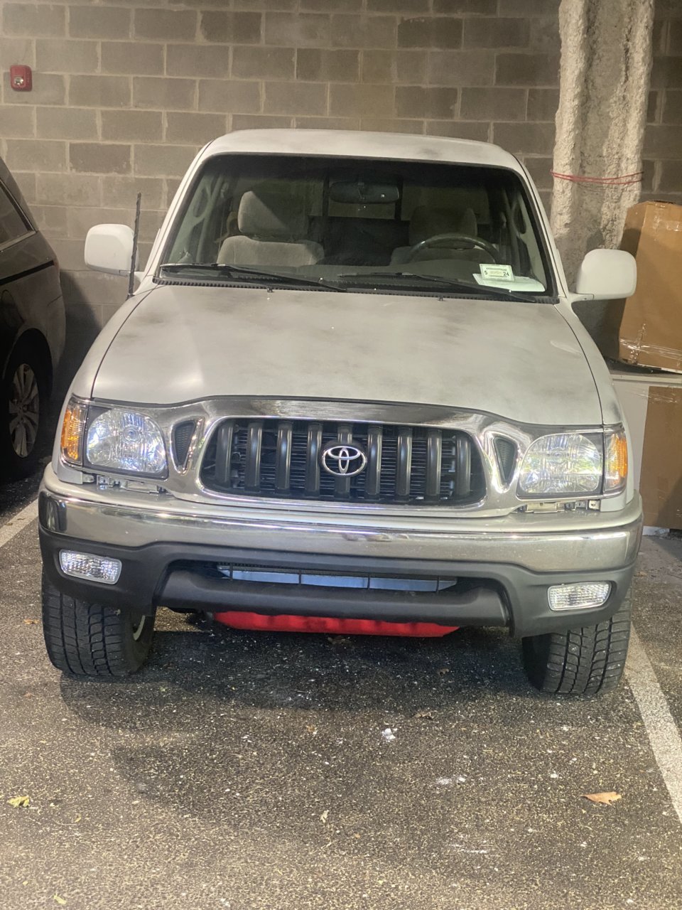

    This is as she stands today.

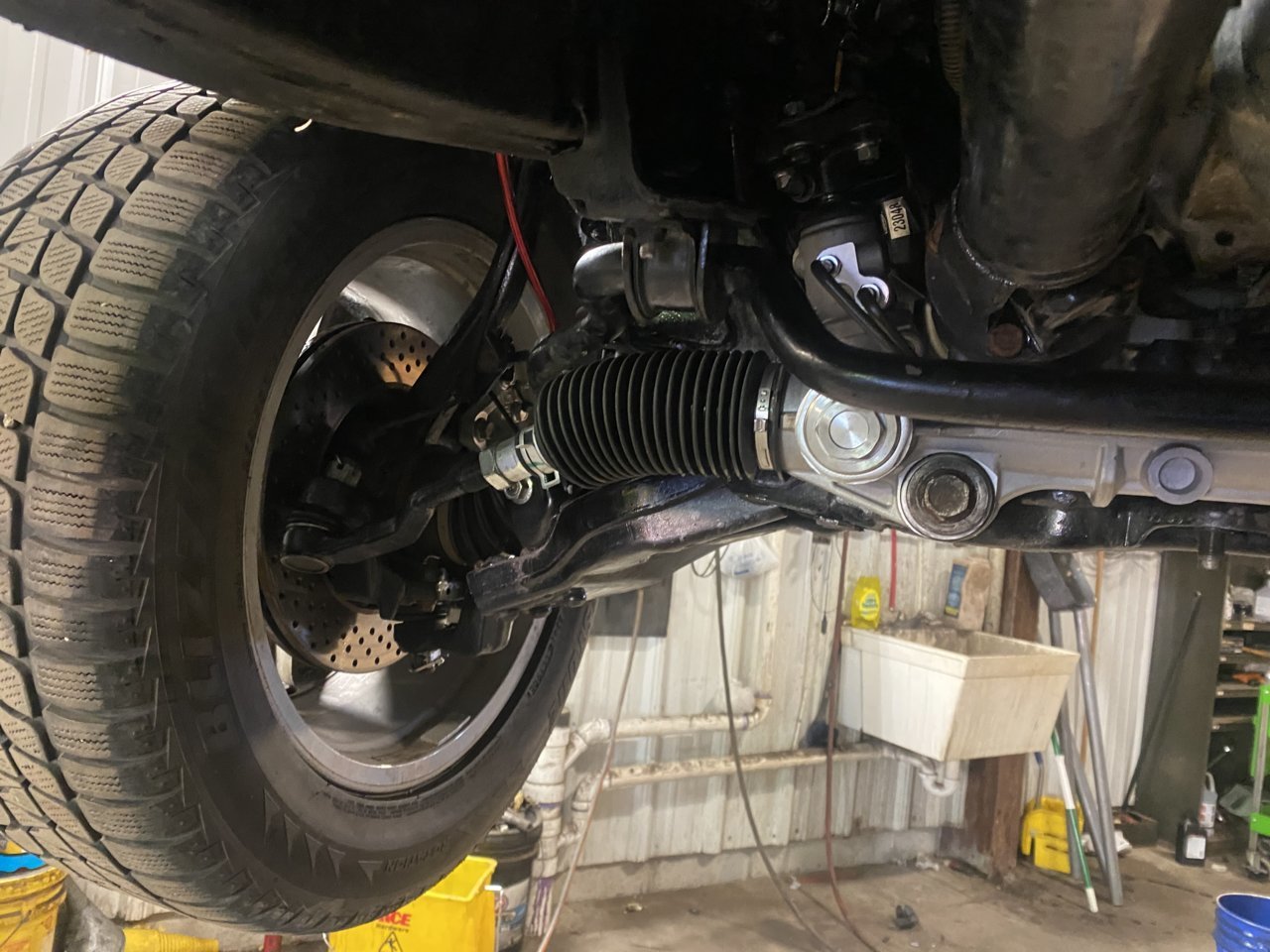

    I drove a 1998 Tacoma and it felt a lot better than mine, no swaying , no road wander, no steering wheel play, no shimming of the steering, I am going to get to the bottom of it, I move my steering wheel back and forth and the spleen at the rack does not move, so there is something for sure wrong with the column of universal or shaft before it gets into the steering rack, this may not FIX all but I am going to look into it, there should NOT be that much movement.
