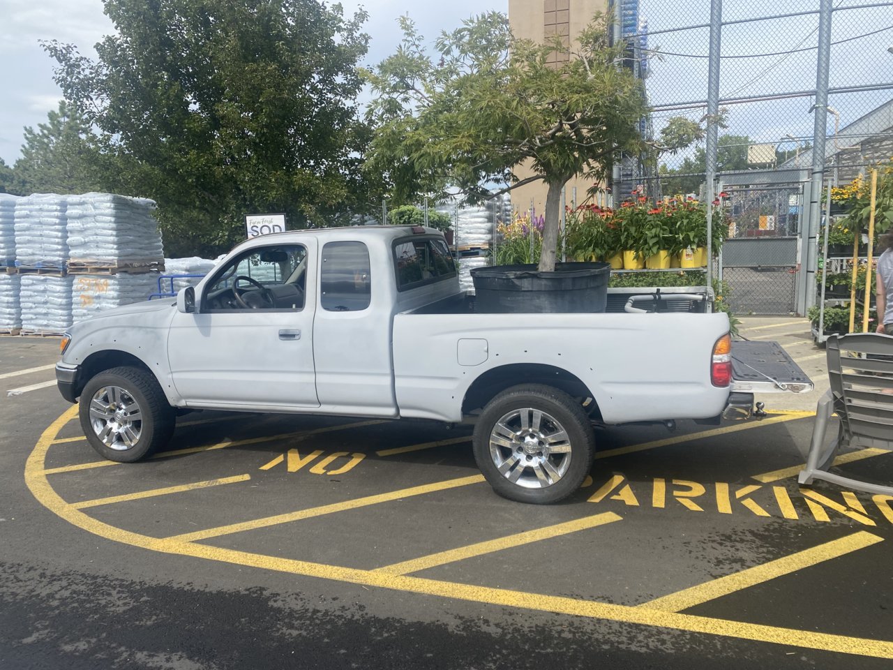

    when I had this Japanese Maple on my truck it drove very good and stable, LoL !

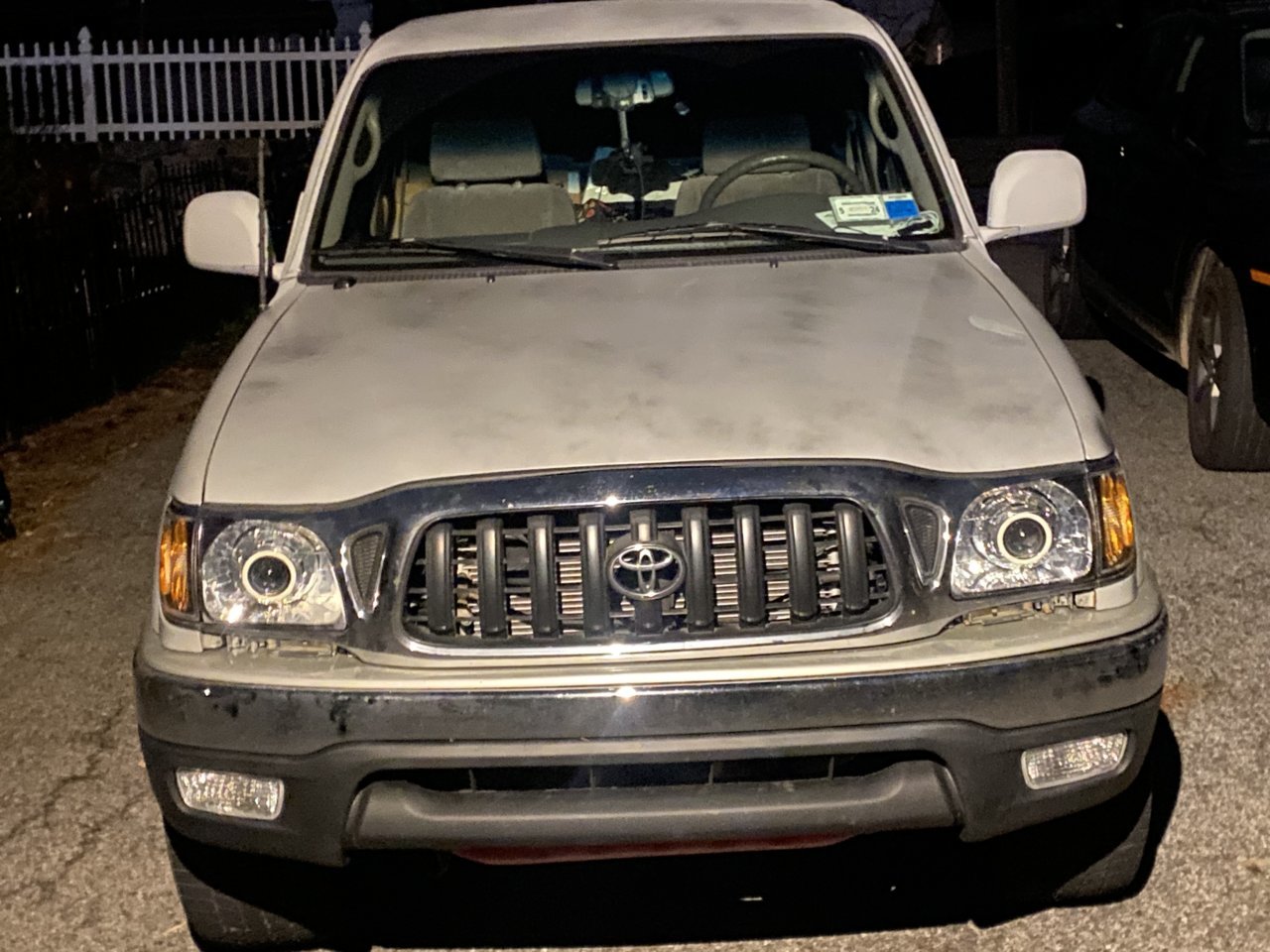

    71B66F01-FEC7-4D4D-9F7F-8F654879C4A3.jpg I had a computerized wheel alignment done, feels a little better, but not there yet. Anyone knows the part number for the front Bilstein shocks that you use when you have a 3" lift? BTW, also running 30 PSi on all 4 , feels better
