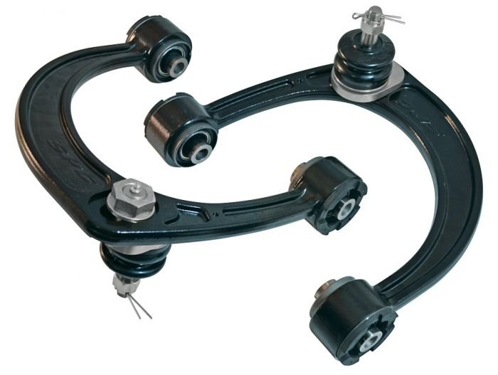

    Has anyone considered that the I.D. of the LR UCA bushing sleeve is slightly bigger than the UCA bolt O.D.? No matter how much you torque the UCA bolt, several thousand pounds will move that UCA.

    I had the same exact setup and issue. Everything fine and then these subtle clunks - under the same circumstances - after installing the SPC UCAs.

    Yea, got it sorted out. Since I bought them on Amazon, I was able to return that first set and received a second set from Amazon. Second set went in and zero clunks.
    Did you install your UCA bolt front to back or back to front? One thing I recall is when I removed the first set, I had initially installed the UCA back to front. The second set I made sure it was front to back. Not sure if installing the bolt front to back played a difference, but no noise now with the second set.

    I think I'm about to take these things off and send them back for another set as well - I've spent way to much time on this thing already.
    I re-installed the UCA bolt front to back, the same way it came off. Just curious, did you get the latest version of these?

    Yup, those are the ones I have. I say get them swapped out. I'm happy with these SPC UCAs.

    Sure enough, I put my stock UCAs back on this weekend and absolutely no clunk.
    Shipping them back for a new set this week - hopefully they send me a good set this time. I'll follow up in a couple weeks after I get the new ones on.

    Just got a call from SPC. Nice guy and it seems like they run a good quality company. He said they got one other set returned with the same issue - was probably your set - and they will be pulling this latest version off the shelf until they figure out the issue. He confirmed my suspicion that it was actually an issue with the new style "bushings" which on these act a lot like another set of ball joints - and in my case feel like bad ball joints.
    Unfortunately they couldn't give me any kind of ETA on when I would get a new set of arms back because they will have to figure out what is wrong with mine first. Sucks for me, but understandable I guess.
