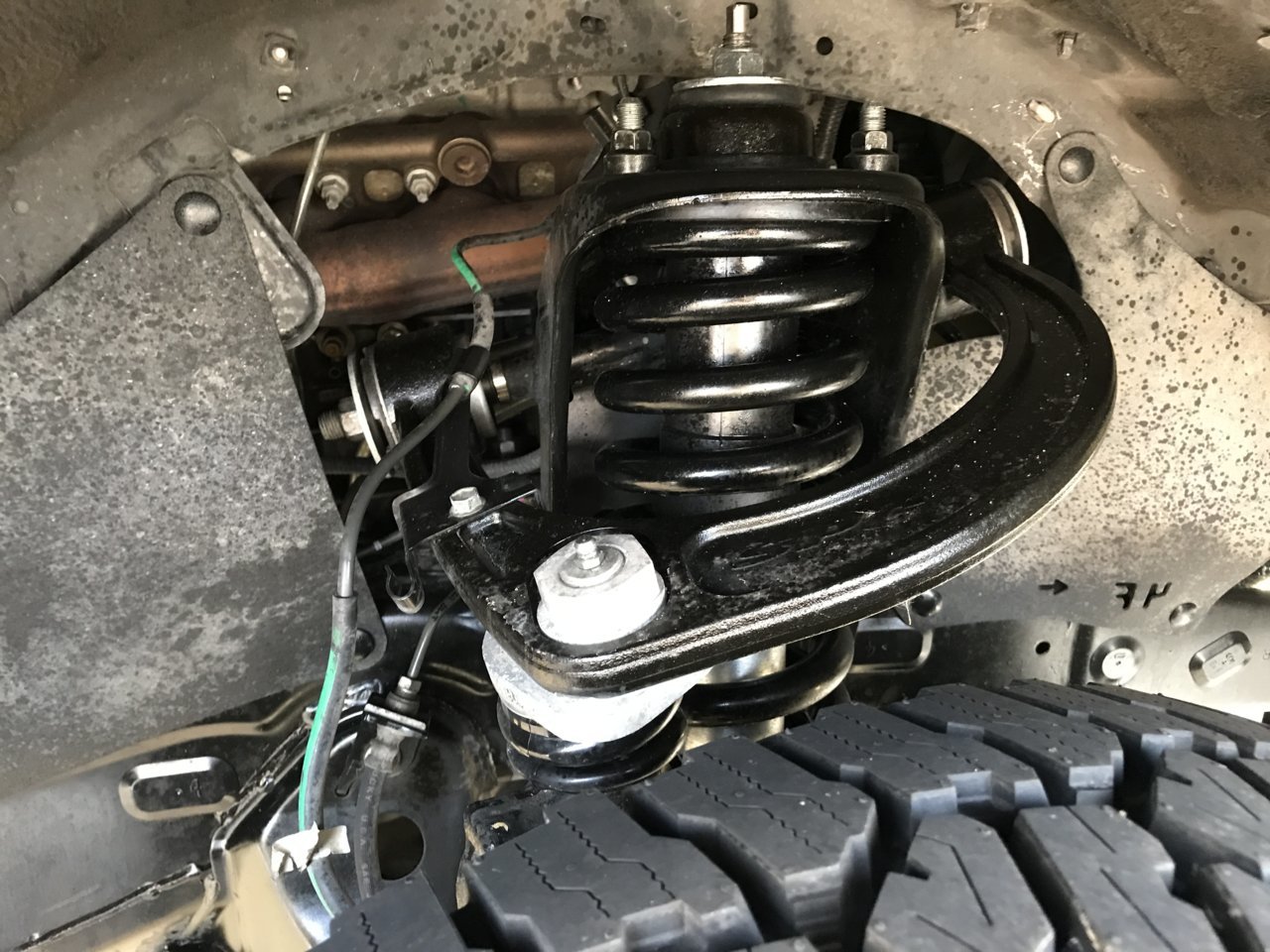

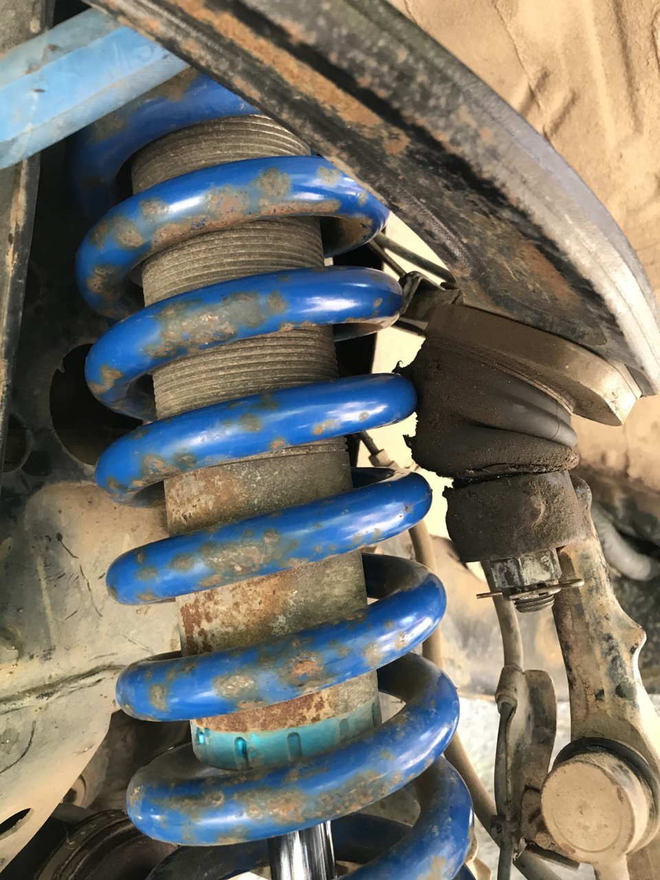

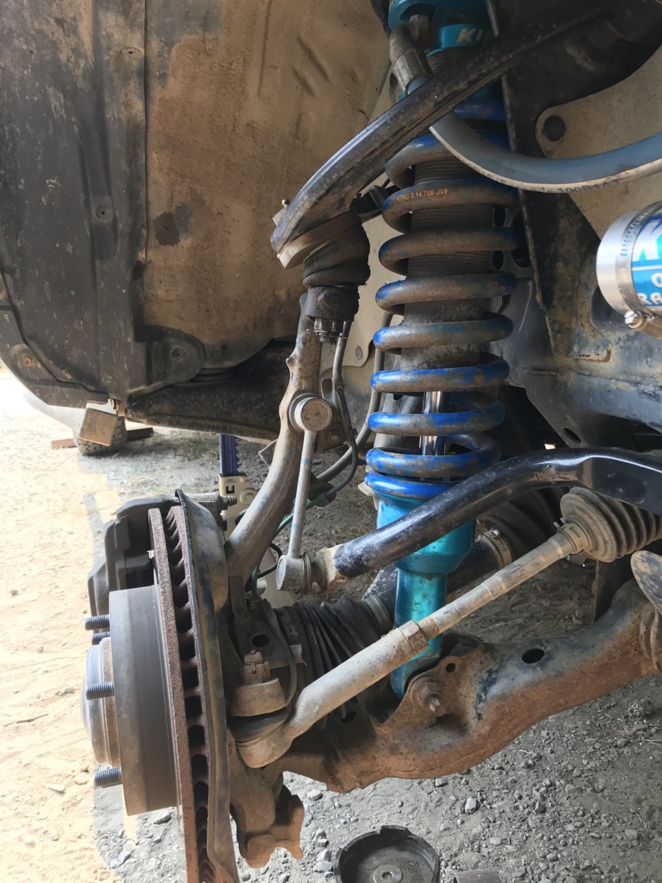

    I bought and installed king ext Tavel 2.5s with SPC UPCs in December of 2019 and I am having a similar issue. Vibration can be felt in floor board at lower speed and a clunk can be heard when I have the steering wheel fully cranked over in a low speed off camber turn (i.e. Driveway with bad approach). I recently rotated my tires and noticed my driver side ball joint making contact with coil at full droop.
    I called SPC this morning and said they had no records of having issues with these UPCs and they did not trust the forums. They believe this problem was due to improper installation. The truck is in the shop now and they are trying to find a setting where no contact occurs. Photos of driver side and passenger below..
