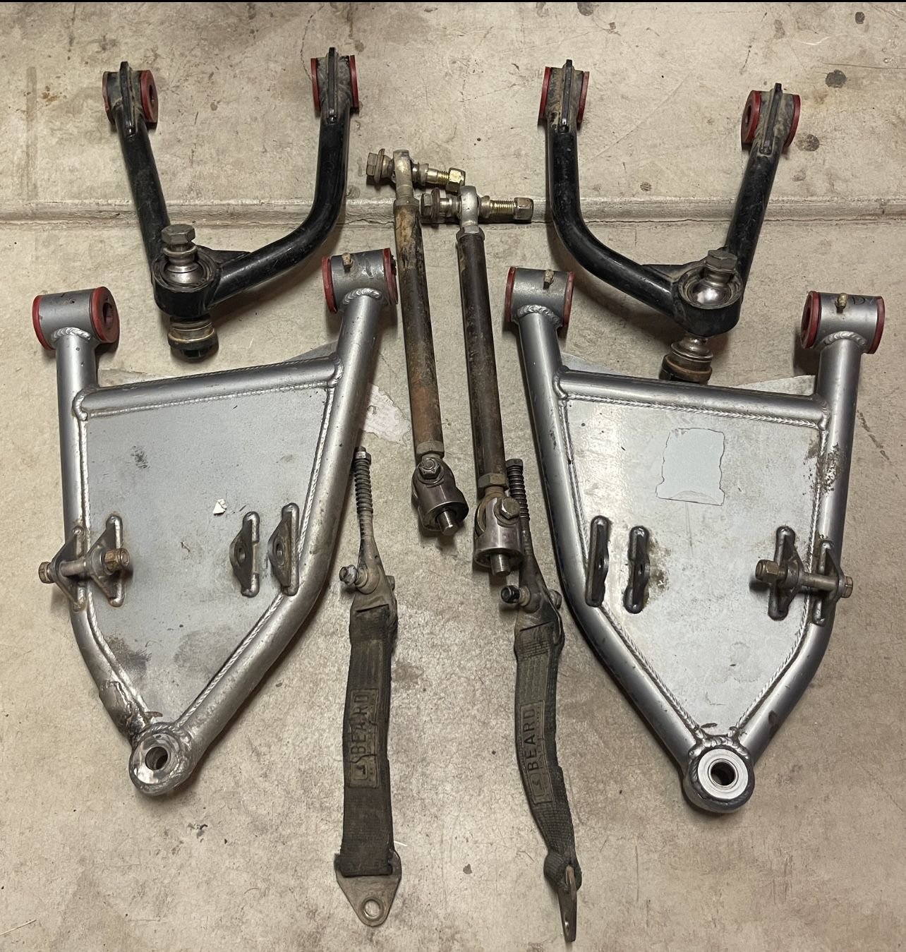

    Thanks, I'll work on that first. In the meantime, I found a LT kit on the used market under 3k but it looks like it was for a 2WD Tacoma. Will this work with extended brake lines and axels, or is anything else needed? Does it still look viable, is there anything else missing, and what's a fair price to pay for the missing axels and brake lines? Thanks again!
    Used Total Chaos long travel kit with upgraded steering and icon 2.5x8 long travel coilovers with remote reservoirs and 600lb springs. Icon coilovers recently rebuilt by Cox shocks with new reservoir hoses
