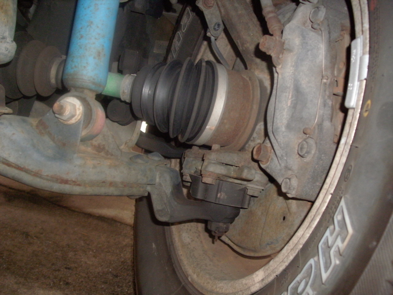

    I've owned my 2003 tacoma for about 9 years or so, and I think it's time for some maintenance. I watched several videos on how to check for play in the lower ball joints, and herein lies my question. I don't seem to have any vertical play from the 6-12 o'clock position, but I do have some horizontal play from the 3-6 o'clock on the passenger side. Does this movement suggest excessive play in the lower ball joint, a wheel bearing, or maybe a tie rod issue. I'm relying on you more experienced TW shade tree mechanics, who've already been there and done that. I was looking at the lower ball joint, and notice there appears to be a square block sitting on top of it, and was wondering what it's purpose is. I don't have anyway to edit or draw on this pic, but it's the black square on top of the ball joint. Or is this play something else entirely.

    Side to side play is generally tie rod ends. Have the ball joints ever been replaced? There is grease/oil residue on the lower control arm so the grease has been leaking from the ball joint boot.

    @sharkrocket I believe the Passenger side was done on a Recall from Toyota. Truck has 134K miles on it, and no hard core off road since I've owned it. I'll take a closer look at my tie rods early next week, since were having a break from the summer heat. :) Thanks for the reply.

    The black thing is just a shroud intended to provide some protection to the conventional rubber boot underneath. Earlier joints do not have it.
    Play at 3 and 6 (only) can be from tie rods ends, very common in 1st gens is a worn steering "rack guide". Simple to replace on the truck. Search for info on that topic and locate where exactly the play is on your truck. The guide was upgraded before 03 but they still wear out, just not as fast as the earlier ones.

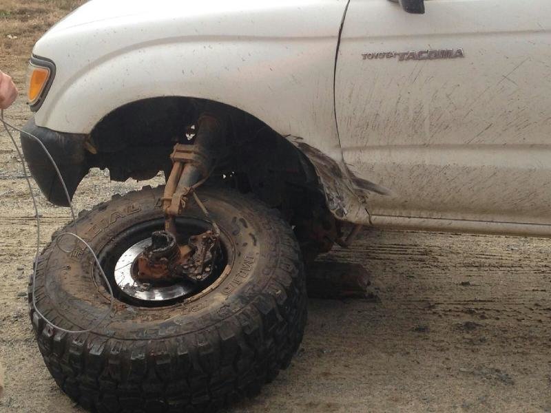

    Ball joints on 1 gens aren't broke until they break. Like this:
    I'd rather do some cheap preventative maintenance to avoid this.
    Not my truck. I replaced LBJ, UBJ, all tie rods, ends, and steering rack bushings, to avoid above.

    was that your truck that the LBJs broke?
