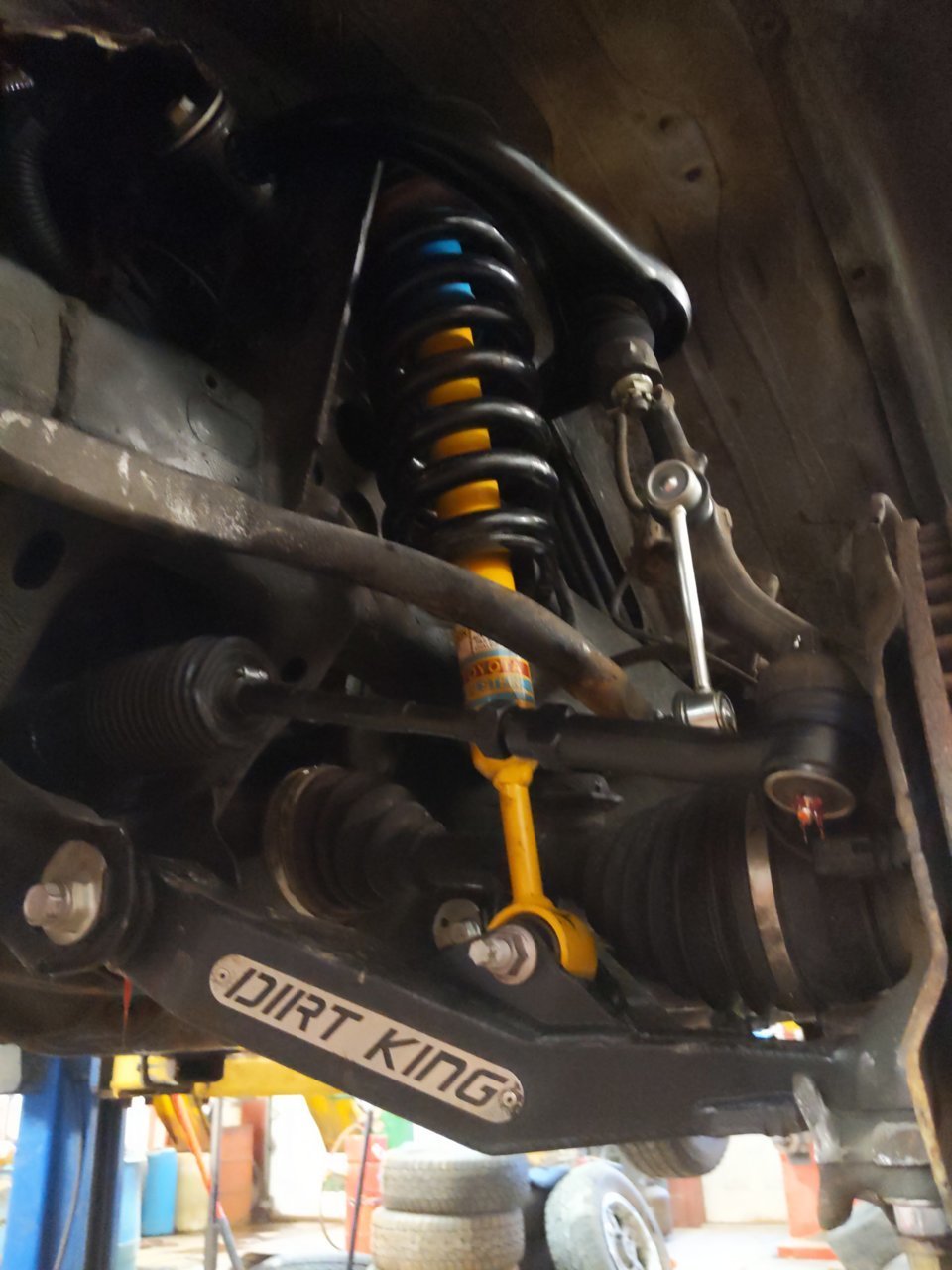

    2009 TRD OR Access Cab super due for a rebuild on the suspension and front end.
    • 3rd gen UCAs and 3rd gen TRD OR shocks and coils (v. low mile take-offs from TW user @jtaco11, nice price and PRO packing and shipping)
    • Used/rebuilt Dirt King Uniball LCAs (from TW user @Mynameisbrandin, excellent transaction)
    • Proforged drop links and complete tie rods
    • Energy Suspension sway bar bushings
    • Apply Amsoil HDMP to suspension hardware (heads, nuts, exposed threads) to attempt to hold off corrosion
    I suspect the Uniballs will be trashed in a year or two due to the Vermont salt, as this truck is a DD that gets wheeled regularly. The price was right and I wanted to see for myself. Out of sheer curiosity I contacted Dirt King about sending them back for conversion to the new BJ version, but they advised it would not be economical. I'm NOT MAD about that, just reporting details.

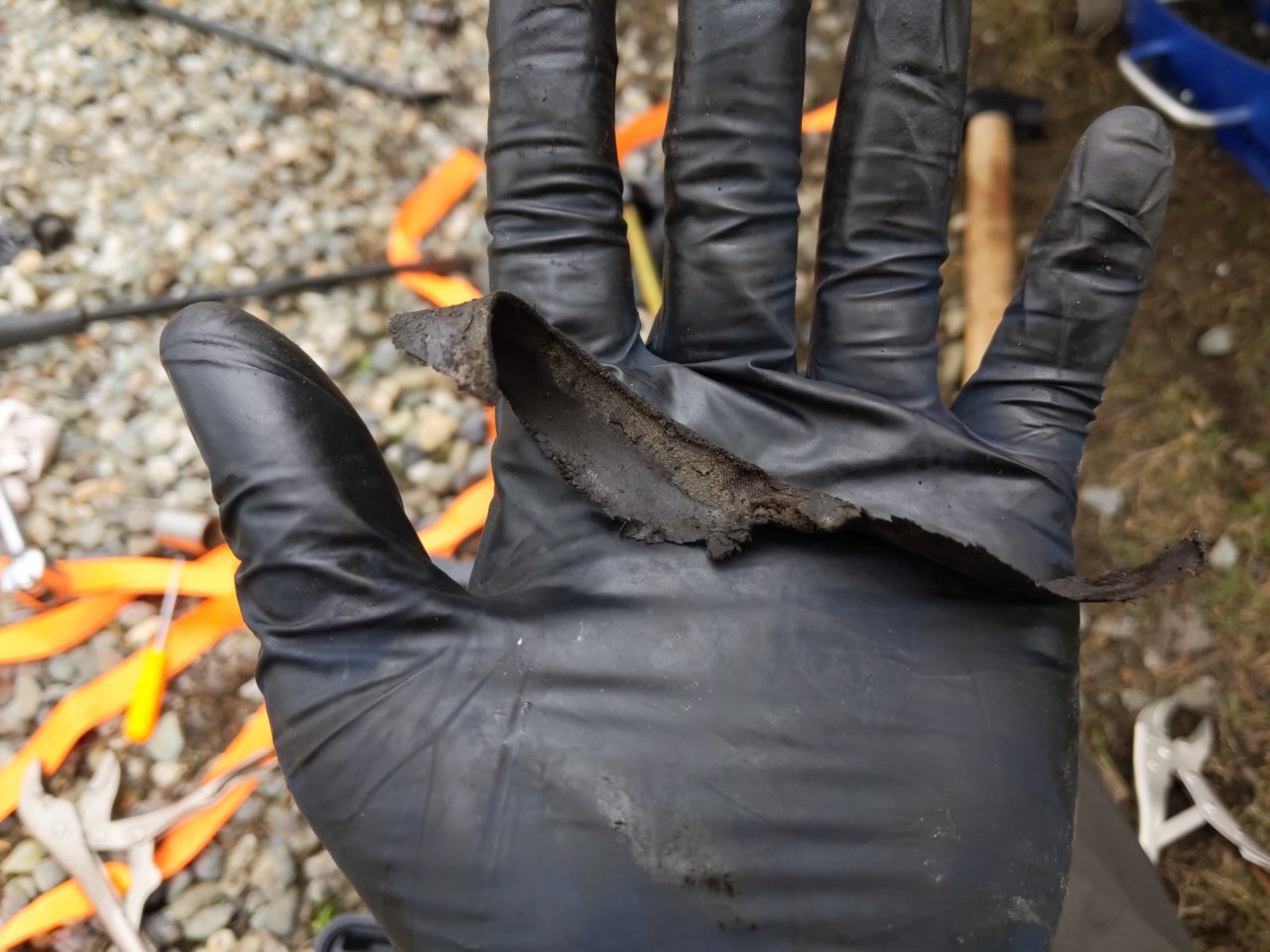

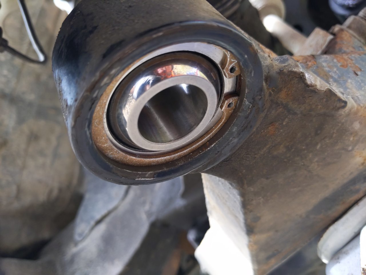

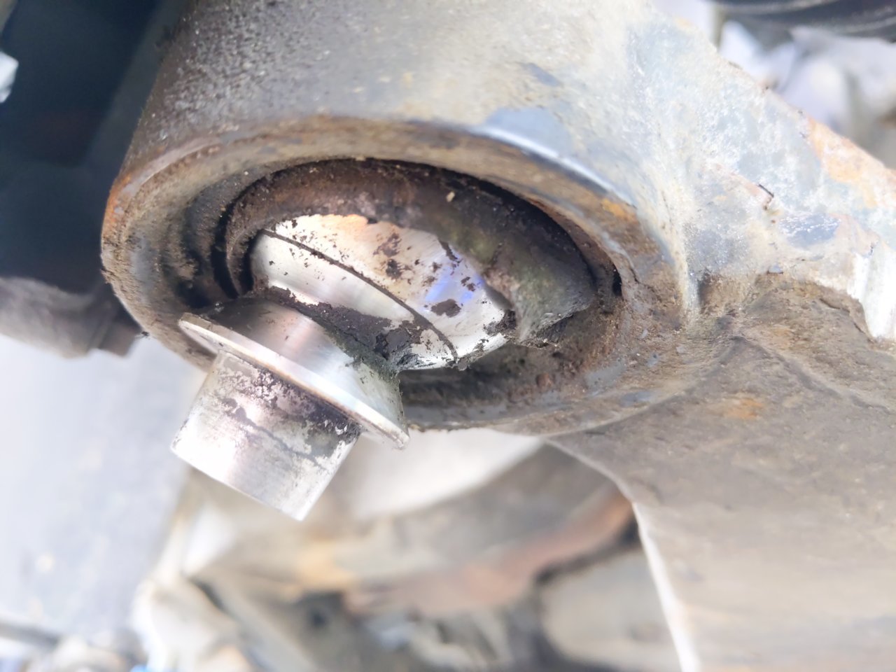

    Yep. She ded ded. Teflon liner shit its guts:

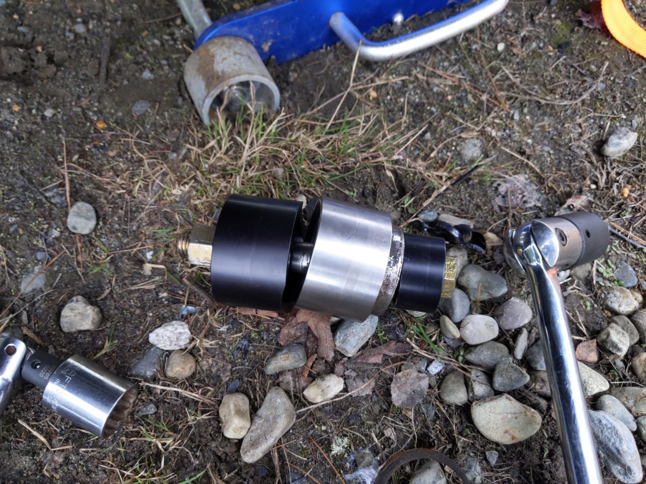

    The offset inserts were stuck pretty good. No room to get them off in-place, so I had to add a spacer (which I was lucky enough to have in the scrap bin) to extract the ball with the Icon "on vehicle" kit:
    Was able to get the top, rounded spacer off easy once the ball was off, had to use PB blaster, a washer and grade 8 bolt as a punch, and a 5 lb hammer to get the bottom, tapered spacer out. There was a little bit of galling, so I cleaned it up with some 600 grit and put a thin film of Nevrseize on it when I put it back in the new ball, which I had to do after pressing the ball into the LCA.

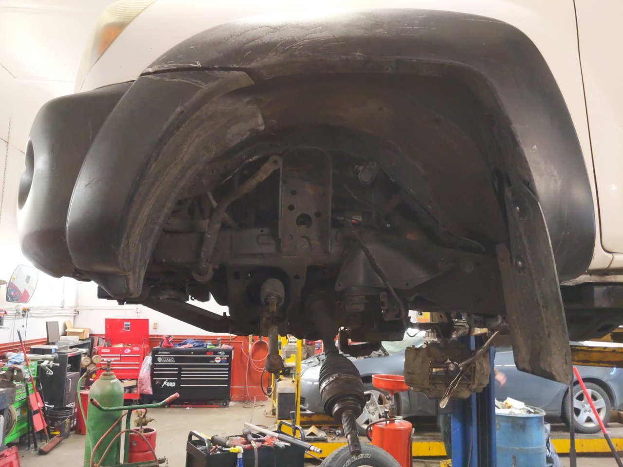

    Pretty uneventful reinstall. First time using the Icon kit. Overall the job was way easier than doing a ball joint. Did the whole thing with the LCA still on and the whole spindle asssembly ratchet strapped up out of the way:
    40-45k miles of mostly neglect on the dead ball. Bad country roads daily, high speed dirt occasionally, offroad frequently, three murder salt winters. I'm not even a little bit mad but they probably aren't for someone who doesn't want to wrench.
