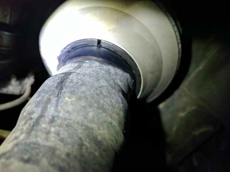

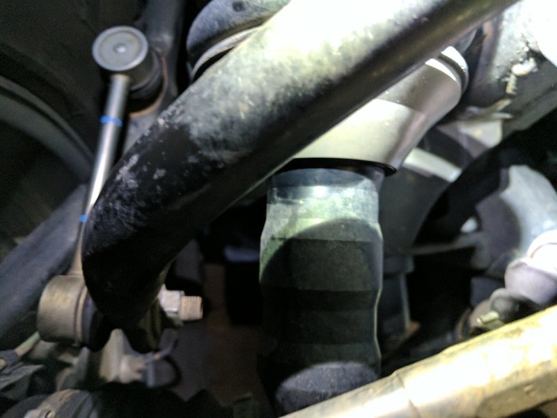

    @0210 and @DCSBFTMFW thank you both for the insight. Late last night I decided to increase the compression and rebound settings on both front coilovers and today the suspension felt much tighter. Of course I suppose that could also be due to the stiffer settings. While I was at it, I thought I would take a look at the coilovers and see if I could see any sort of leaking. This is what I saw:
    Not sure if it's normal. This is just the passenger side and the driver side looks similar. I sent these photos to ARB so we will see what they say. Their customer care has always treated me right in the past.

    I dunno if that's a leak, per se.. not my area of confidence.
    I seem to recall a guy had a definite leak and they replied it was normal "weeping," even though he had like shock oil on his floor every night.
    I think in the end he got taken care of but I don't remember what the username was.

    It's hard to say because the rubber boots cover/hide the shock's shaft. There does seem to be some residue on these boots, but I can't say for sure. Look for greasy areas at the bottom of your shock, and even the Lower control arms. As well as drips where you normally park.
    You may also be able to push down the rubber boot with your fingers to have a look at the shaft itself.

    ARB got back to me and said they think it's assembly oil coming out after heat cycles from the strut. He suggested that I clean it and keep an eye on it. If it slows down and not so much comes out, then his theory will hold true. Otherwise, I might have an issue.
    I will say that today during my commute I noticed no thuds or feelings of loose suspension after changing my compression and rebound settings. Perhaps they just did not like the setting I had them on. I had them set on the softer side for my truck setup. To be honest, I like they way it feels now too. Thank you @DCSBFTMFW, @jakebray, @0210 and @Bishop84 for all your inputs. Let's hope this fixes the issue.

    If you've stiffened the compression and the noise went away, that would suggest that the shock was bottoming out before. In normal (city) driving, that shouldn't happen even on the softest settings. If it was, and has now gone away, that almost certainly means the shock is leaking.
    Cleaning it up and keeping an eye on it is a good idea. I'd suggest a very thorough clean with some sort of mild detergent to ensure everything is as clean as possible, and then do your best to stay out of rain/snow/mud/etc. for a few days of normal "daily" driving. Then get under there with a flash light and pull down/back that rubber boot to look at the shock's shaft.
