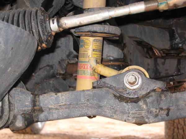

    To each his own on the front being higher but having a spacer lift and being that high, your asking for more headaches down the road with issues like CVs wearing out and shocks potentially getting destroyed like the pic below (not mine). Good luck OP

    How many different people has this happen to? I see this pic posted all over this forum. I feel like there is more to this story than just caused by the shock spacer. Just my opinion lol
