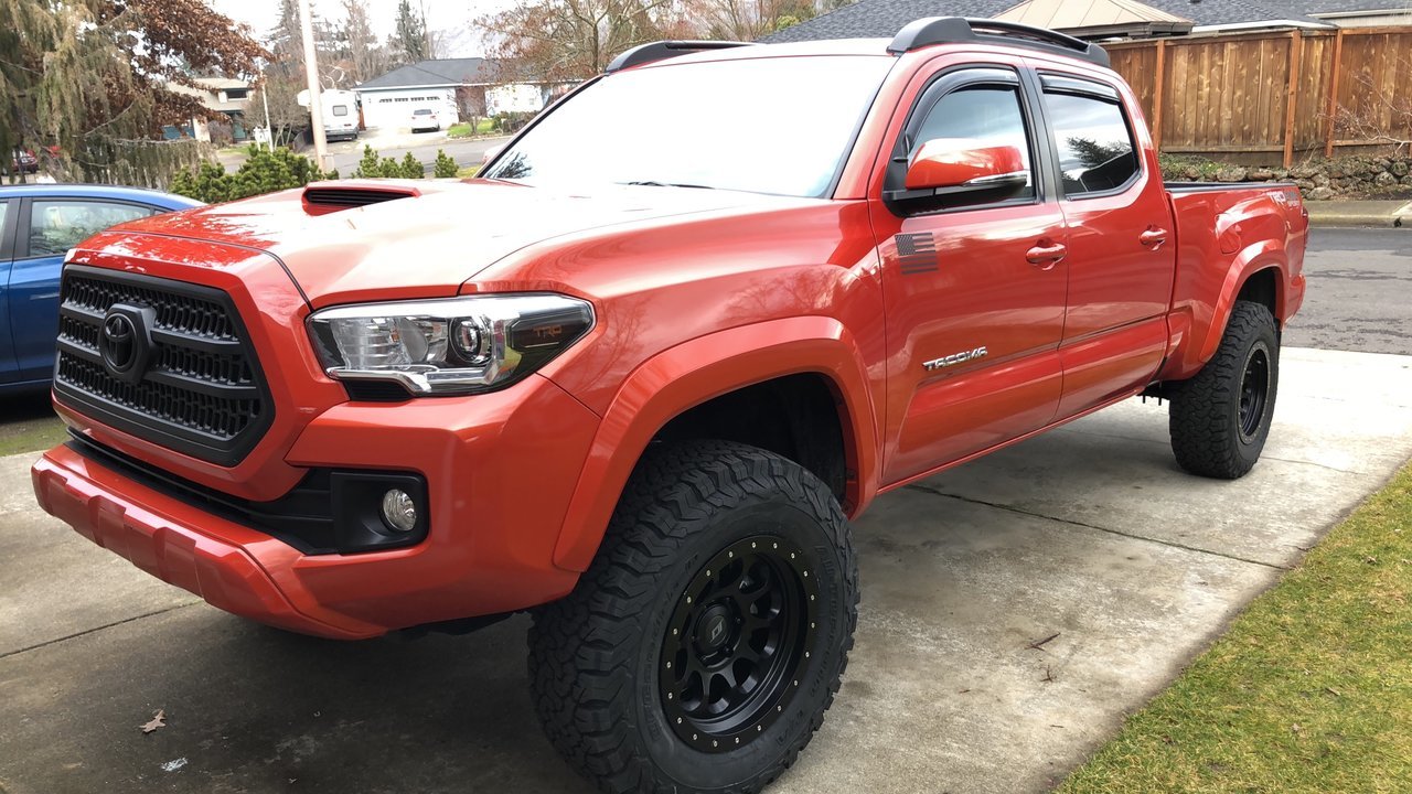

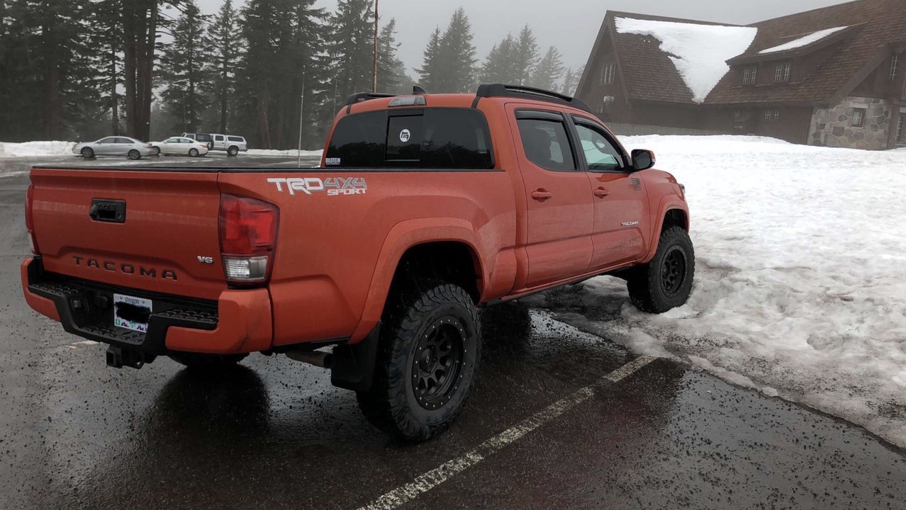

    Just do 1”. I did 5100’s all corners with a 1” block in the rear. Rides better than stock and No issues whatsoever! I was skeptical at first but at 1” it sits just right. Gives it a whole different look and it’s affordable, and you ain’t dealing with the crap you would above 2”.

    That is exactly what I am talking about! Wow! Great looking truck.

    Thanks man! I’ve been driving it for over a week now with the lift and zero complaints. Your normal drop in MPG happened, only by about 3/4 of a mile. And a slight vibration due to the 10 ply tires. Super happy with the results and the way it sits!
