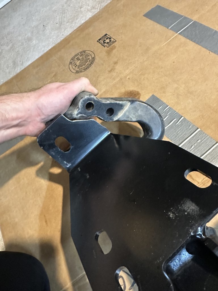

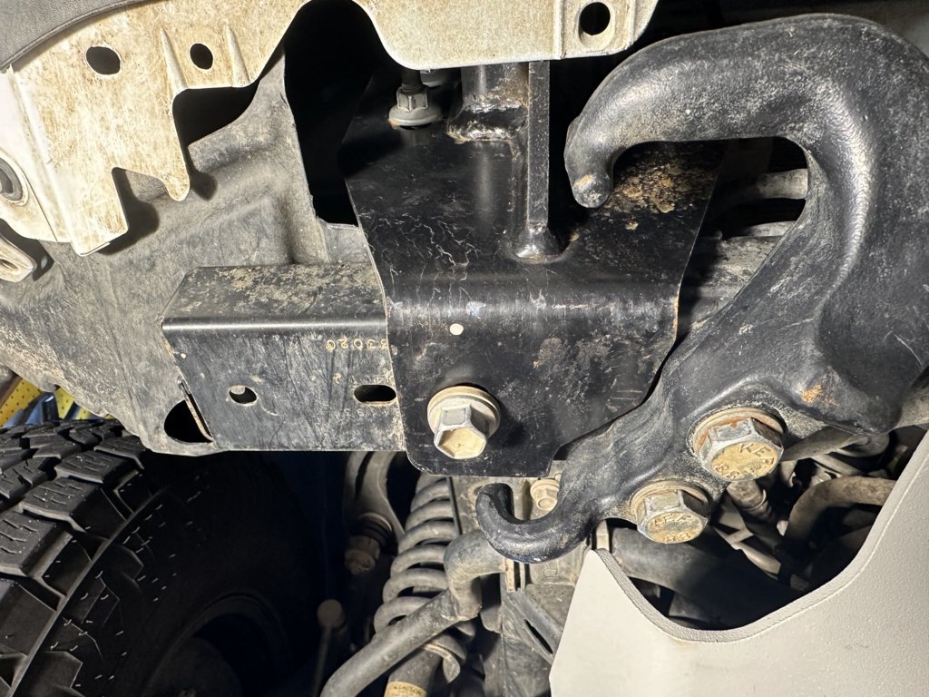

    I'm not who you asked but I'll reply since he got the Mobtown which isn't sold anymore and I got the 4x Innovations one that's supposedly the same basic thing with a bit more gusseting for strength. Here's the link with current price being $325 plus shipping (I think shipping was $25 or so) https://www.4xinnovations.com/2016--2023-Tacoma-Front-Hidden-Hitch-Receiver_p_191.html
    Install time was 3 hours or so with me being really careful with everything. A more experienced person probably could've done it faster. It also includes time spent cutting out a piece for the front tow hook (see pics).
