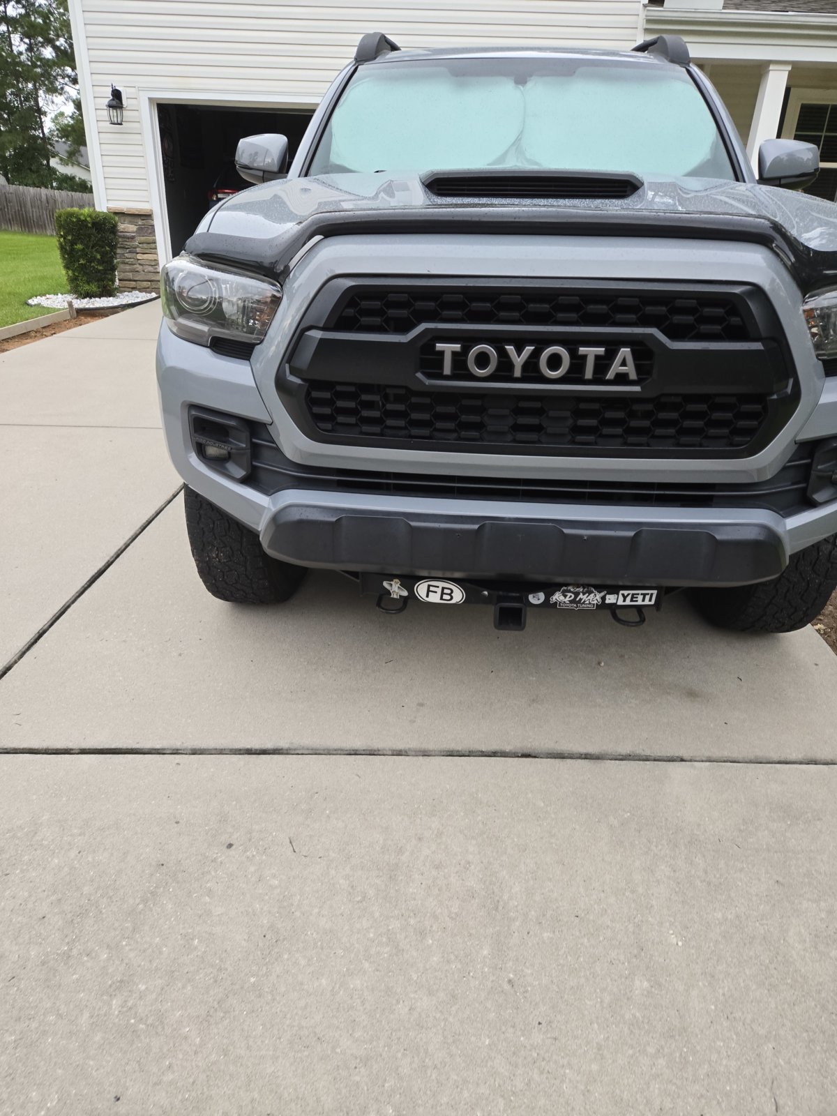

    I know this was years ago, but did you decide anything for a front hitch? Does it fit around a TRD Pro type front skid plate?
  16. Jul 25, 2024 at 9:34 AM
    #36
    frankybones
    frankybones Well-Known Member
    Feb 28, 2010
    #32248
    298
    Frank
    Summerville SC
    2017 TRD PRO - CEMENT

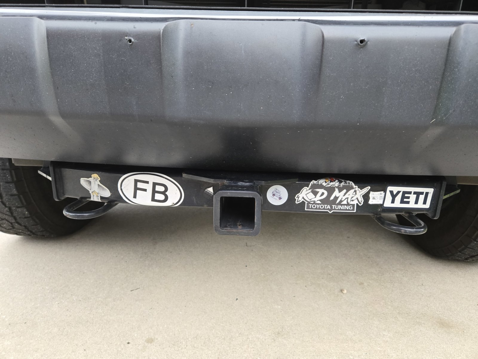

    It fits with the 17 TRD pro skid plate I still have mine on and use it occasionally for my ebike when I have the families bikes on the back bike rack. You lose some ground clearance but I don't rock crawl or off road much. If you need the ground clearance I would not install it.

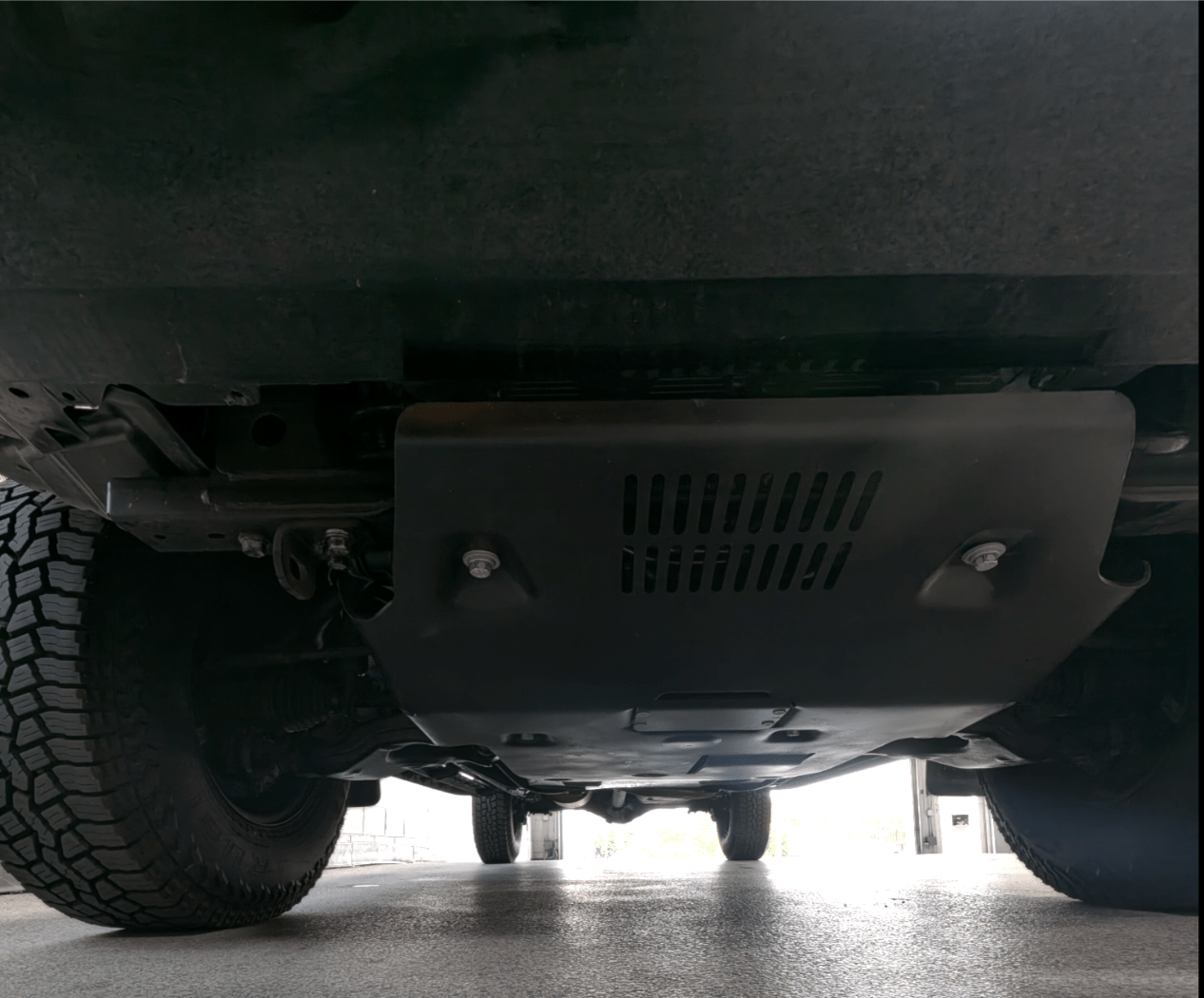

    Wow, Thanks! so the Curt 31075 front hitch bolted on just fine, no need to trim or adjust the aluminum TRD pro skid?!
    How long do you think it really took/rakes to install or uninstall the front hitch mount?
    i was just thinking of getting the curt as front hitch for occasional light cargo carrying, and long
    i don’t really offroad either, so not too worried about clearance, though wonder if it affects wind noise or anything else noticeably. I don’t have the often declared on the internet as aesthetically unpopular airdam thing installed currently.
    I recently installed an aluminum generic copy of the TRD pro skid, but i got it mainly as part of a plan to protect the Catalytic shield better, and the oil change cover looking easy, plus being cheapest relatively lightweight front skid. It should have take 20 minutes to install, but took more like 2-3 hours to get it in right, no lift and aligning was a little tricky. Thought maybe i mixed up the bolts/washers placement , but they were correct. I ended up trimming the tips off the front bolts and adding a couple regular washers to the front most two bolts.

    It was installed by a local shop it was cheap money at the time and I was worried about the trimming as well. I just looked at it and looks like the front was trimmed. I don't even notice it's there unless I need it so no to wind noise. Here are some pics for reference. I have no regrets it comes in handy.20240725_172003.jpg 20240725_172003.jpg 20240725_172009.jpg 20240725_172027.jpg 20240725_172009.jpg

    @frankybones pictures much appreciated. If i go for the front receiver thing, now i know what i’m in for. :hattip::bowdown:
    This is a big deal to expect ahead of time in terms of plowing ahead, versus getting sidetracked by unexpected fit problems!
    Right now looks like:
    ~$200 for the Curt hitch 30175 shipped.
    Whatever rack/addon to use with it, $60-$300.
    Plus install time/effort, which i guess includes cutting.
    I think the imitation TRD skidwas about $170 off ebay, it was light grey, i rattle canned it black before installing.

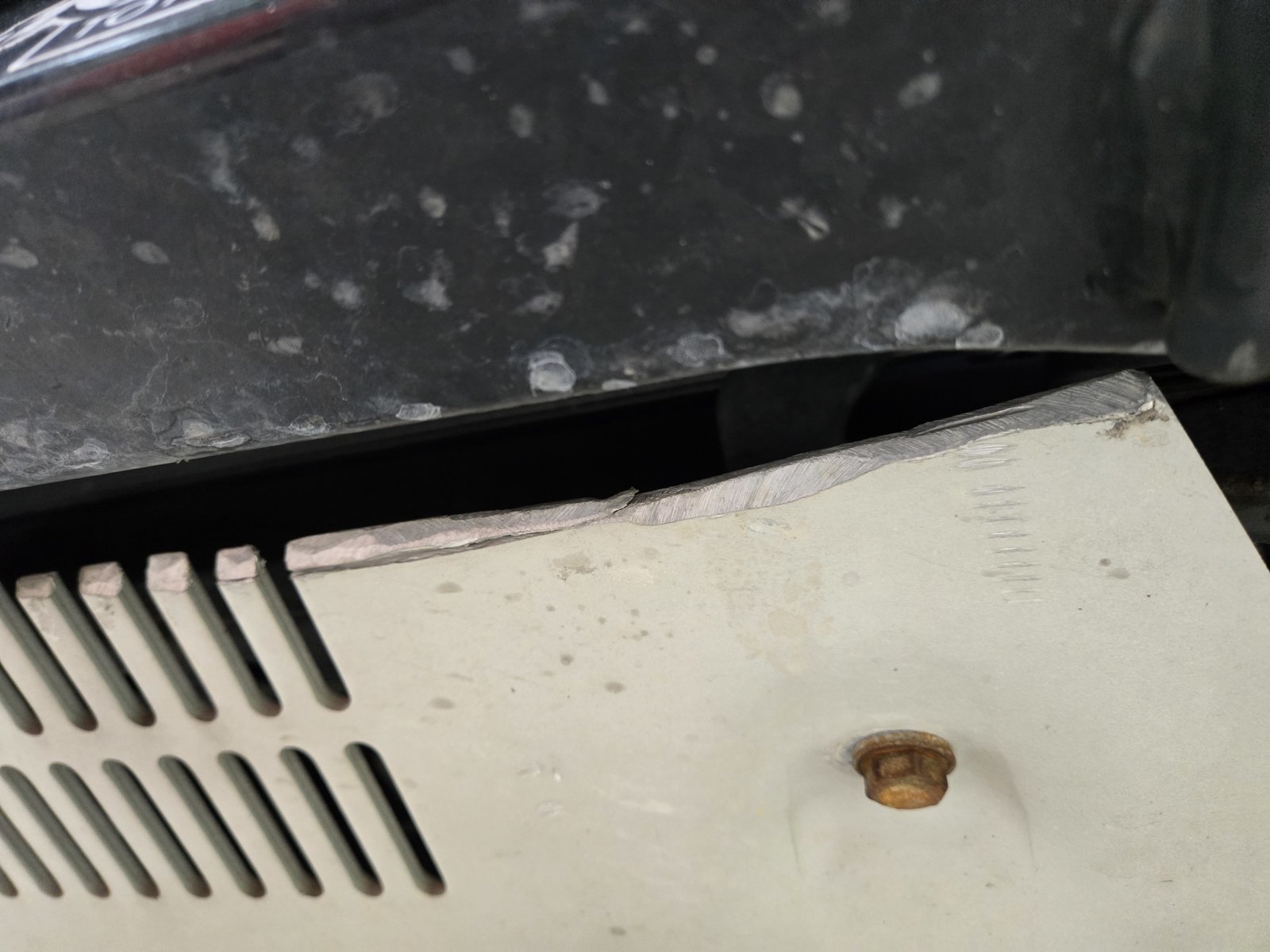

    this is what my truck looks like now with the skid plate not cut:
    #40
