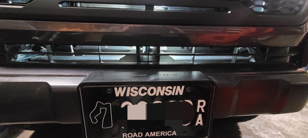

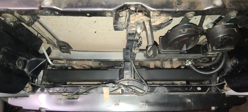

    20250102_162103.jpg Before I cut the plastic 'grill' piece. You can see it butts up right to the back of it. v

    Oh there's no way that's holding a shackle, maybe if you removed the license plate holder?

    Pros and cons. lol
    Depends what you're looking for.
    Rest the d ring on the bumper or let it hang down underneath the bumper where a branch can snag it? :D

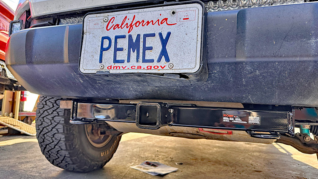

    I put the Curt front hitch on my 2021 MT Sport.
    I've used it three times to pull others out of snowy ditches.

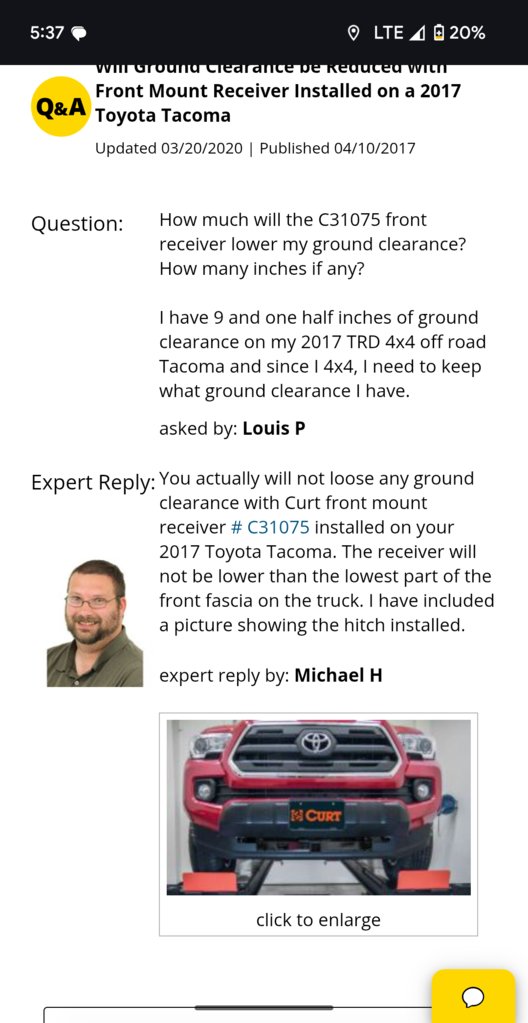

    That's the exact shield I was looking at if I went with the curt. Looks like it doesn't hang too low past the skid.
    Sweet- Ever have any problems with clearance??
