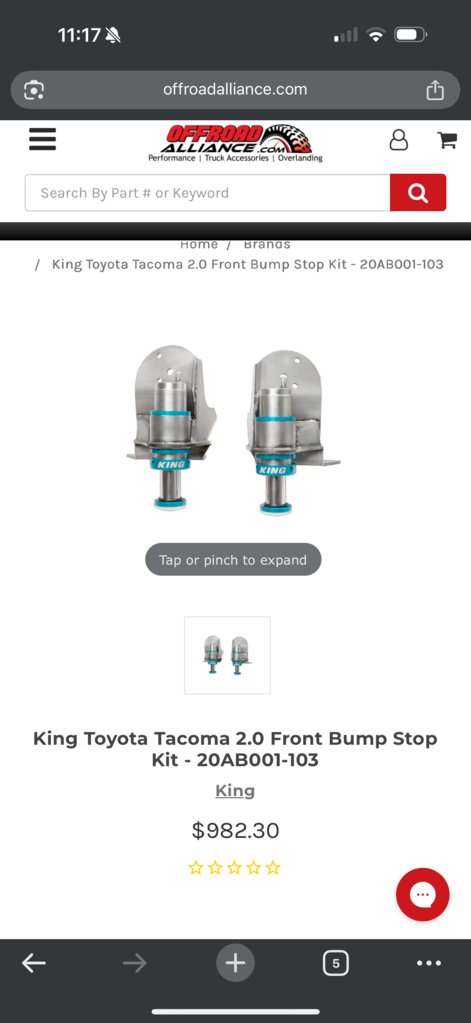

    I’ve been upgrading my suspension on stock frame and I haven’t found any hydraulic bump stops for the front, only for the rear. I came across off road alliance and it doesn’t really specify the fit for it, do you guys know of any upgrades besides the “sumo” style stops?

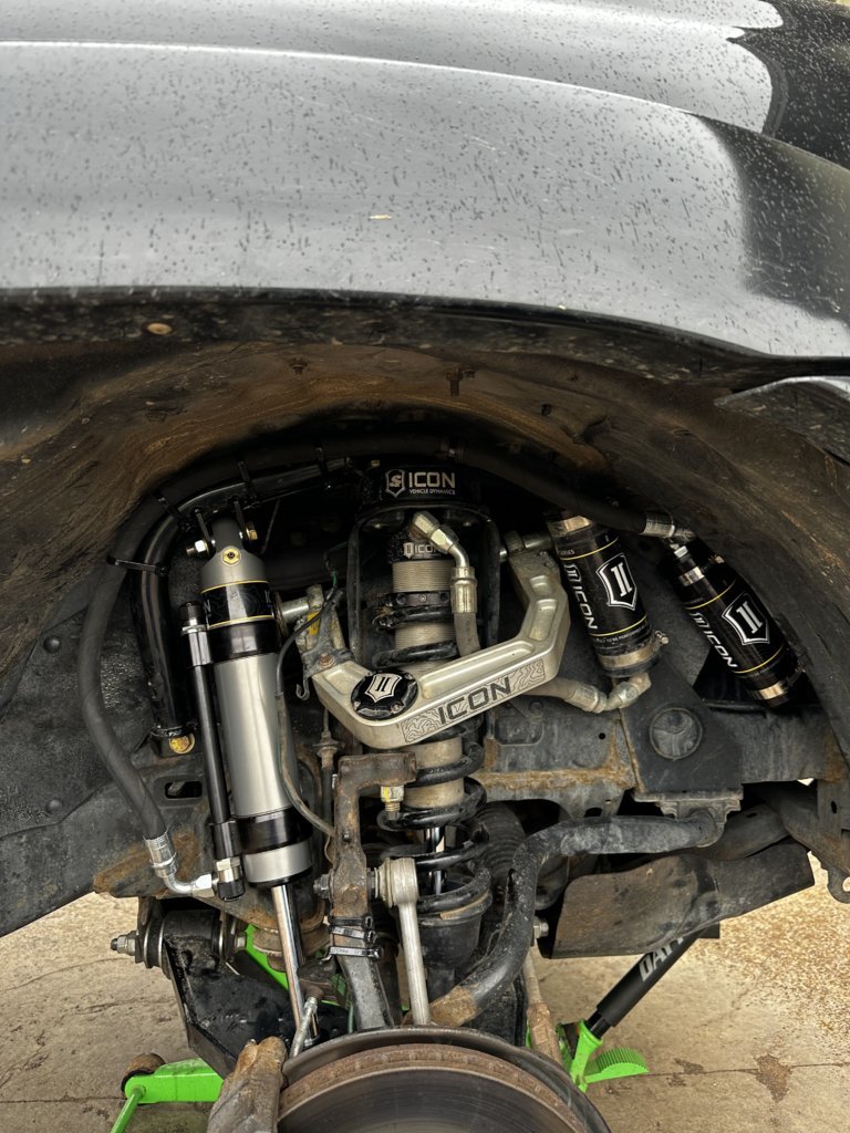

    That’s my current front setup

    Is it your daily or dedicated desert truck? I only ask because wheelers super bumps are $130 and you’re talking $1k+ for a hydro bump set up. I mean obviously they hydros will outperform poly bumps but I’m just trying to be realistic.
    Pretty solid set up there. Yeah like I said I feel like space is the issue with front bump stops but you could do something, probably custom work involved.

    Realistically I don't see a reason that kit wouldn't fit a 2nd gen if it fits a 3rd gen. Their design is to cut out the oem bump stop off the frame and weld that assembly in its place.
    One of the reasons you don't see front hydro bump kits more commonly is the leverage and lack of arm movement of the location the factory bump is in. The bump stop is really close to the LCA frame mount so the arc the arm travels in in that area means that a hydro bump would be engaged almost all the time and would likely impact normal ride quality. The best way to do it would be a 'slapper' style setup like Camburg does on some of their kits(very common on their Raptor stuff)

    So I would have to get a different shock? The one I have is the compression and rebound adjustment shock but it doesn’t have the specific point of travel adjustment that I would get with say a bypass king shock.
    I stuck with Icon because I get great warranty with all my components since they are part of the same kit in a way.

    He has Icon's version of a bypass shock, but it bolts onto the stock LCA skid I think. @COLDTACO2
    I don't think you would need to start replacing shocks. You can revalve the secondary one that you have.
    Total Chaos makes a mid travel bypass LCA, but I think it would be a replacement to what you have. I actually have their mid travel bypassed setup with Kings. Mine are revalved too, and it's my daily driver.
