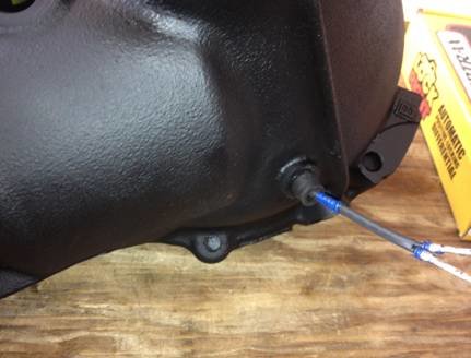

    Well locker is installed and complete with some modifications, waiting for chases response as wither he wants to post or not.

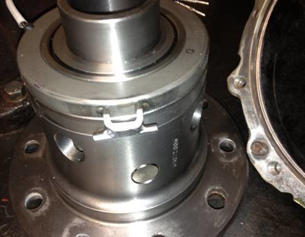

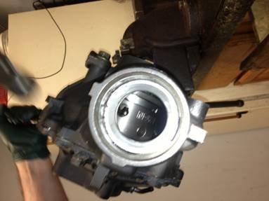

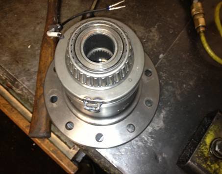

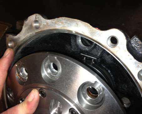

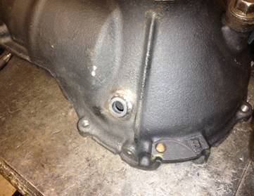

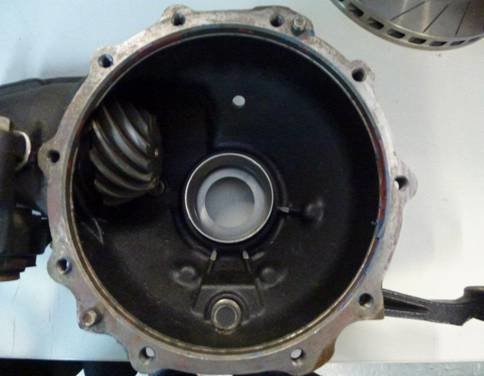

    ECGS
    HARROP / EATON A10994-0 TOYOTA 8” REVERSE CLAMSHELL INSTALL T8CS
    USA APPLICATION: 2003 + 4RUNNER, 2005+ TACO, FJ CRUISER FRONT DIFFERENTIAL
    ***Be sure to select correct model number: Aftermarket T8CS 4.56 AND 4.88 ARE THICK CUT TO FIT 3.73 CARRIER
    Step 1. Grind Fins inside case for magnet clearance approximately .300
    PICTURE CO HARROP
    Step 2. Install carrier bearings only, Not ring gear and test fit, you will find that the anti rotation tab binds on housing and will not let carrier bearing seat all the way. Orientation of tab is between fins at drain plug. If you bolt case half together you will likely damage the unit.
    Step 3. Cut the magnet anti-rotation tang off at outer weld, shorten legs .065 or until you can install carrier by hand and it does not contact housing. Original tab pictured below.
    Step 4. Tig weld both legs on the inner side and tig weld a cross piece to brace the legs. Reinstall and insure that the tab can move .080 back and forth between case fins.
    Step 5. Install ring gear. Remove pinion gear if not removed. Paint a safe zone line for wire clearance through pinion hole to judge for grommet hole. Also see above picture for hole placement. Hole size is ½ inch.
    Step 6. With pinion still removed, install carrier and grommet in hole insuring anti rotation tab is aligned in case fins. Bolt case half together and set wire length by viewing amount of wire pull. Wire should have enough slack so that the magnet can rotate freely without pulling on grommet or interfere with ring gear. Mark wire position on the outside of Grommet so on final assembly you know that wire placement internally is correct. We used Blue tape to mark correct location.
    Step 7. Tig weld bung with ½ inner diameter to outside of hole drilled. Do to the thin wall of the clamshell and the design of grommet more material needs to be added.
    Step 8. Proceed to set pinion depth and backlash, Final install pinion and reinstall carrier Insuring anti rotation tab is aligned between fins in case. Coat outside of Grommet with RTV and set wire length.
    Step 9. Seal case, install ADD stub shaft, ADD tube, and reinstall Differential.

    Very interesting. Doesn't seem like too much more work on top of setting up the clamshell normally. I had to read an re-read it though.
