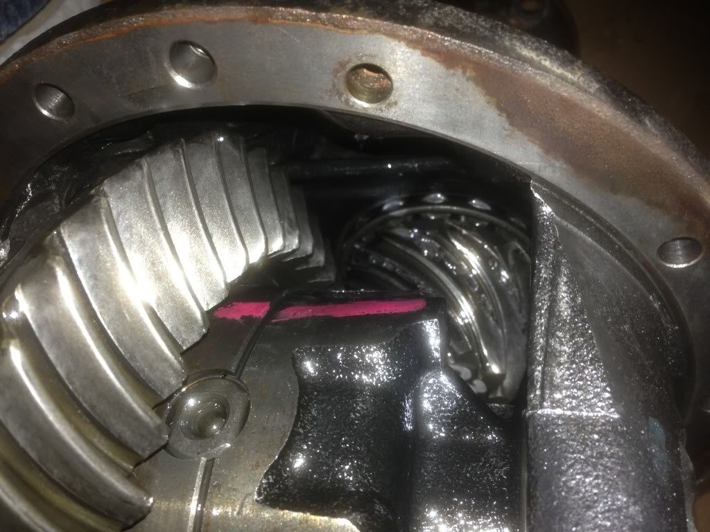

    Well finally after my holidays got to inbox the diffs and with no surprise with my luck there was damage to the elocker wiring. Literally crushed to the point of seperation. And popped the grommet back into the housing. Minor easy fixes. Weld the cable back to get her and rtv the living shit out of the opening and grommet. Hooked up to battery and locker engaged just fine so close call. Tomorrow I'm whirring and relocating cb mic and install locker tomorrow night. Going to be a long day tomorrow.

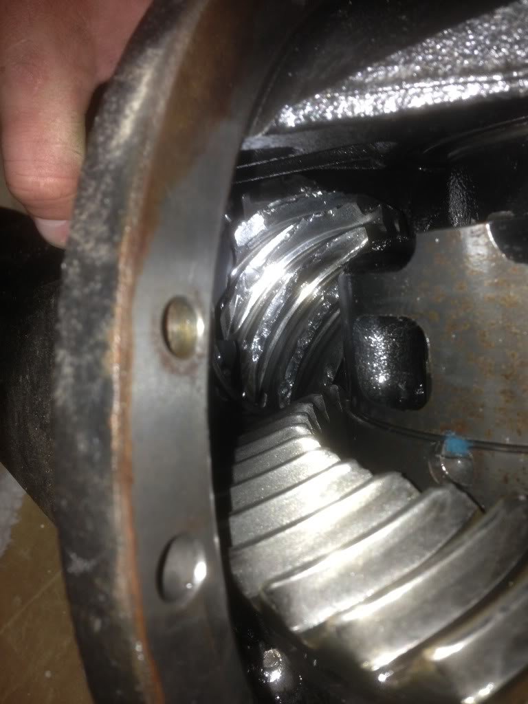

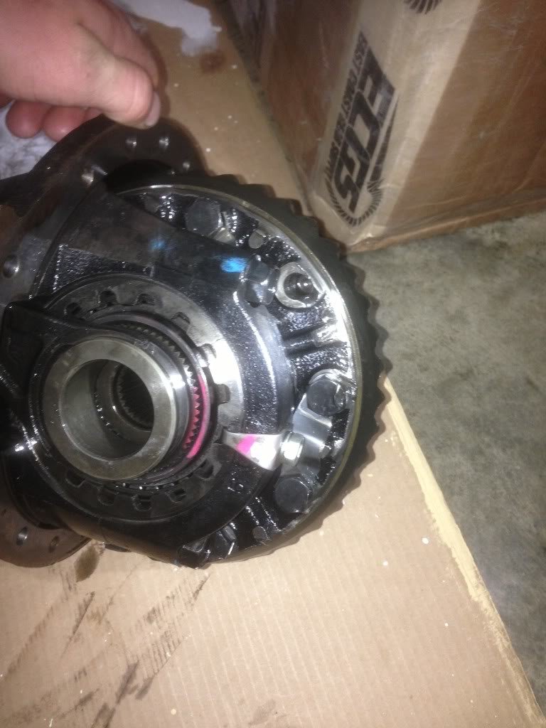

    4:41 am I am tired and going to bed, rear diff was destroyed no idea how I was still driving and front elocker is in and operationalpics to follow of my angry cat. For now bed

    Let's see pictures of the Carnage

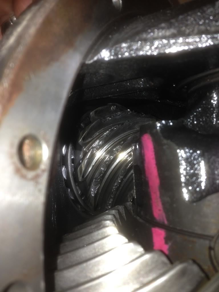

    No no no that is the old one. New one is awesome. My current challenge is recalibrating the speedometer, oh front e locker works like a champ

    Yeah just in time I think took some time to clean out the housing.
