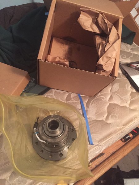

    Melbourne FL
    2020 Kawasaki Vulcan S ABS
  13. Dec 9, 2016 at 7:57 PM
    #73
  14. Dec 10, 2016 at 6:38 AM
