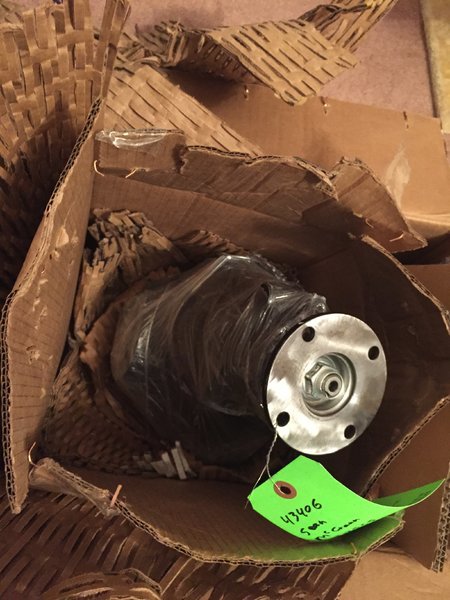

    Got the call from ECGS today. It done and enroute to me. It only took them 2 days, so I'm guessing it was a pretty straightforward install.

  20. Jul 1, 2016 at 12:38 PM
    #20
    smmarine
    smmarine [OP] Well-Known Member
    Apr 3, 2013
    #101279
    6,524
    Melbourne FL
    2020 Kawasaki Vulcan S ABS
    It's like Christmas!
