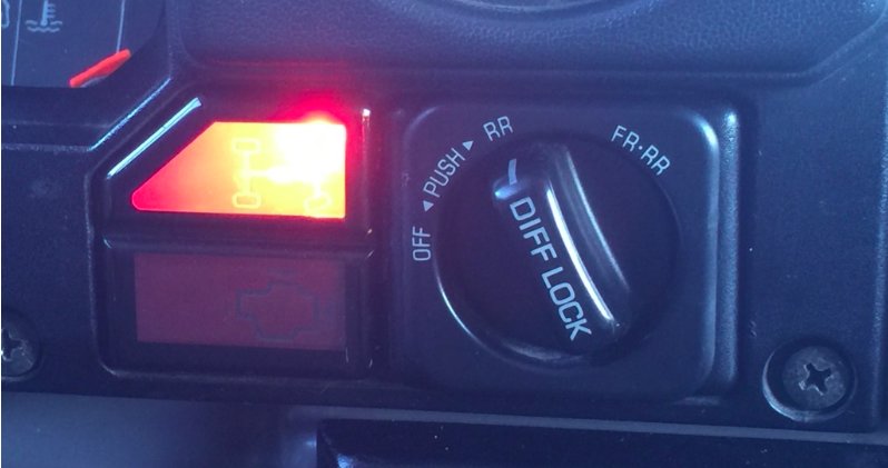

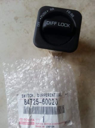

    Thanks, Sean!!
    Here are some images if it helps. Also, a 4WD Toyota Owner Mag article by my partner for his 100 Series front.
    Happy to email installation directions if anyone is interested.

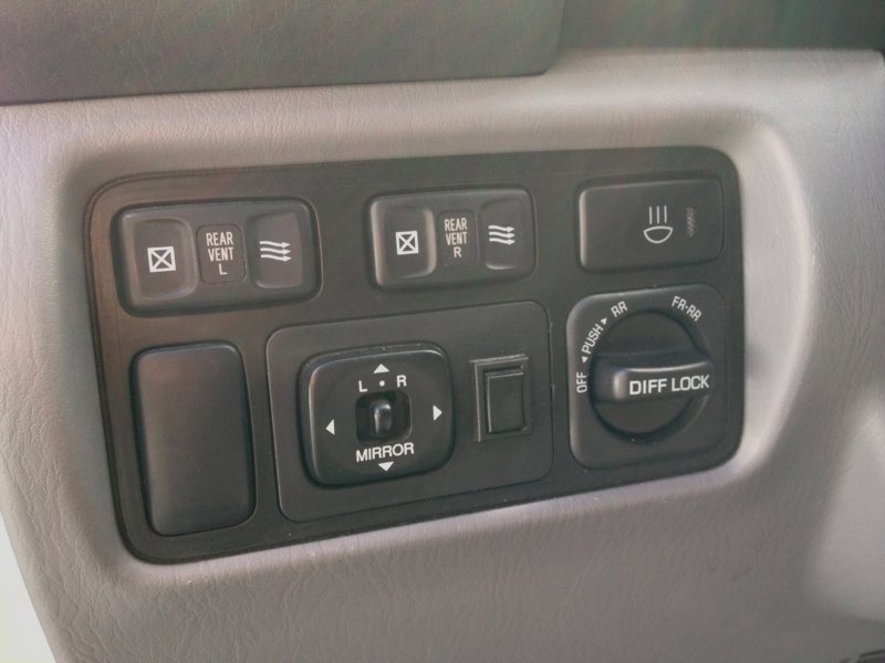

    Or, you could swap in an 80/100 Series two-locker rotary switch into the clock panel in first generation Tacomas.
    We have a box of these and include one when requested...second photo shows one installed in my BJ 73. It has two Harrops and works well with one switch. Hand goes easily to single switch - no hunting/looking. Also a safety feature, as I never want to have my front actuated without the rear engaged as well.
