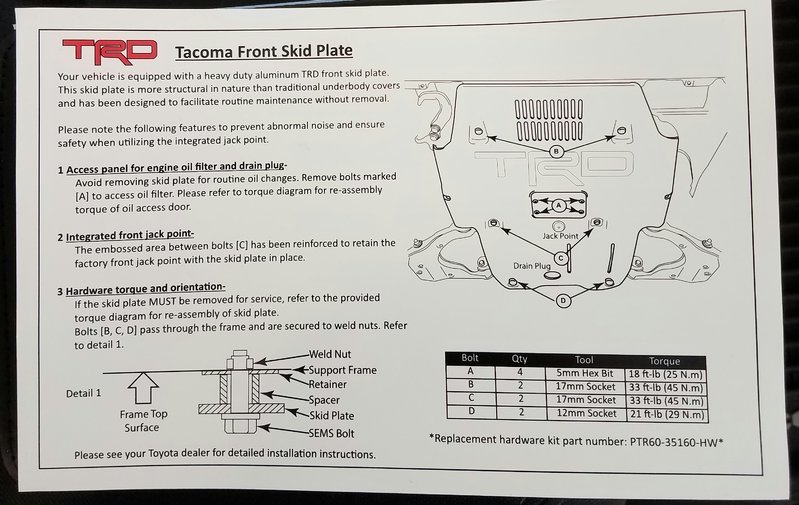

    @Joe23 Owners manual jack point is nowhere near the OR's factory skid. See picture below.
    The spot in post #2 is the one mentioned in the FSM to use with a floor jack to get the entire nose in the air to where you can then put jack stands on each side. It's in the center, further forward than this spot. (ahead of the front axles in fact)

    RIDERED67
    RIDERED67 Well-Known Member
    Oct 22, 2016
    #200382
    2,327
    2017 TRD OFFROAD QUICKSAND, DCLB, TECH
    Here ya go

    This is good to know. I must have missed this when I put mine on.

    Many thanx for the great pic for the front jack point!

    This got the better of me and I just crawled underneath my SR. Guess what? At that exact jack point for the front wheels--that hole in the cross member--I have a rather obvious bright GRAY plastic insert! You can't miss it! WOILA!
    Thanks, Toyota!

    I always wondered this. Because if you take your truck into a shop and they put it on their rotary lift... they never check the exact points from the manual and I think just put it on the frame rails. So these points in the manual are only for jack stands?

    thank you Ridered67 (post 23) for that info. i as wondering the same as i just used a floor jack for the first time on my ‘99 Tacoma. true story. it’s been maintained by the same shop in SF, Ca since my first oil change.
