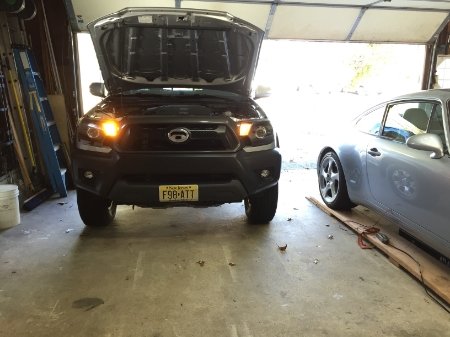

    (making assumption your 2006 is wired in a similar fashion to the later ones...)
    the nice thing about the VLED system is the built in resistors inside their control modules are only online when the signal is active. all other times its off. the control box is cool to the touch while in operation. i am very satisfied with the VLED system.
    as for the tails, you can use your own resistors there and they will only be active when the signal is on cause thats the only time they are powered anyways.
    VLED on passenger side, csjumpers LED on drivers side. massive difference in RL. the VLED are equivalent or a little brighter than stock.
