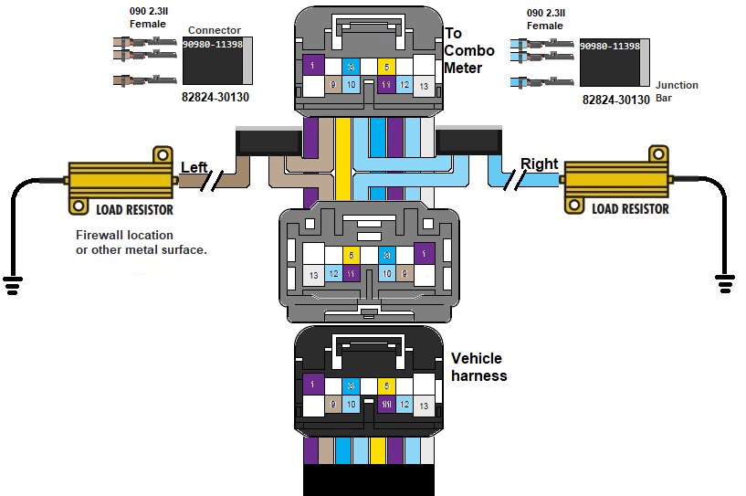

    So I just purchased GTR lighting CANBUS 2.0 front LED signal amber lights for my 2021 Tacoma. While driving tonight I noticed the left signal started hyper flashing after sitting at a left turn stop light for a minute. The reason I bought those bulbs was because I didn’t have to buy any load balancers or resistors for them. Any reason why they would be hyper flashing?

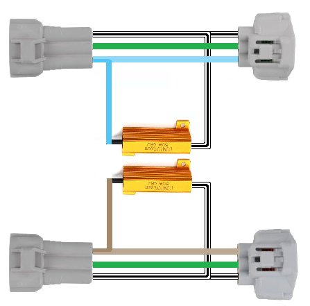

    I can make a harness that adds the capacity for resistors that would be plug and play if you’re interested. The hyper flash on these trucks is very temperamental.

    I can help with that too :D

    T harness to C10 - Combination Meter turn signal connector.
    T harness to headlight turn signal's connectors.
