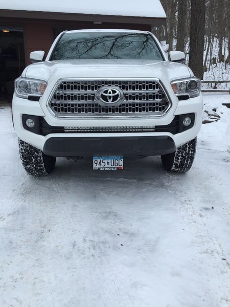

    There is two unused holes on the factory front skid plate. Tap them and use a couple of bolts with L brackets. Works great. Looked at the two bolts on the underneath but was worried if it caught something it might break the plastic mounts image.jpg
