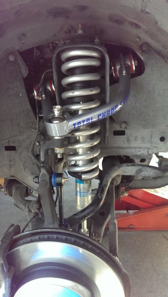

    I was one of the cheap bastards that did the strut lift in the front. I should of just burned my money instead of putting that on my truck. I finally replaced it today with bilstein 5100's and Eibach 2.5 lifting shocks plus a 1/4 spacer for the taco gangster lean to the drivers side. I am at factory alignment and it rides amazing. I have ZERO complaints!!!! I highly recommend this set up. I have a revtex 1.25 inch lifting block in the the rear with 5100 shocks as well. great set up. I have took my truck off road only thing I haven't done is jump the pig.

    agreed! i did the spacers. boy did that cause problems. just a heads up. loosen the nut on yout uca while the truck is on the ground. i realized beyond common duh the other day that the bushings are locked in one position. when you lift them they are still clocked for oem ride height and are now in a bind. if you just break it loose and tighten it back up you will hear them spring into the rite clock back to zero tension at current ride height. made a difference in ride quality. same with the lowers. but with an alignment they will spring into place anyway

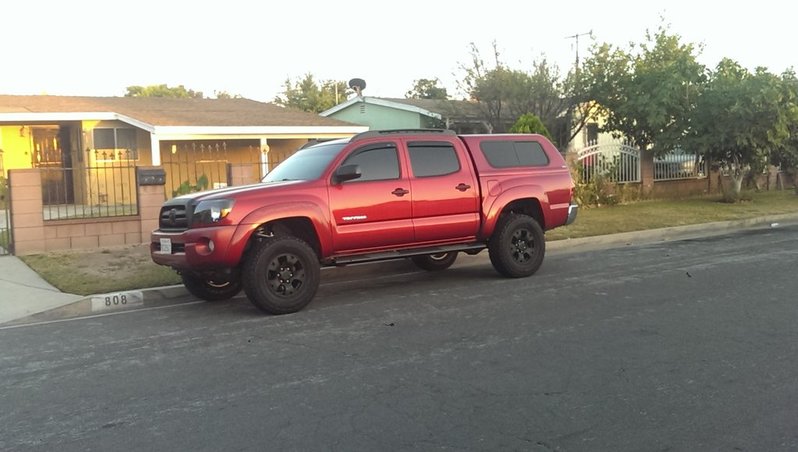

    IMAG0023.jpgIMAG0025.jpg I got the eibachs n 5100s to I thought it lift 3" but u probably need the 1/2"spacers to gt the 3 inches and in the back I got the aal
