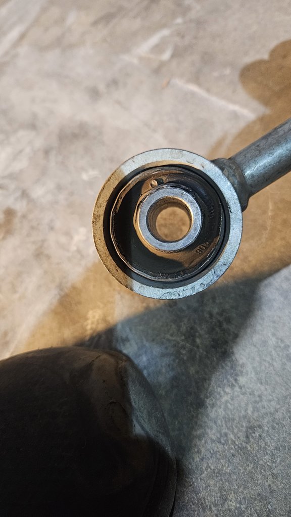

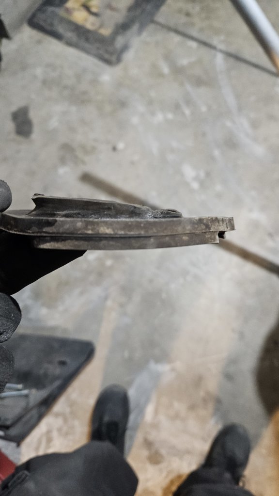

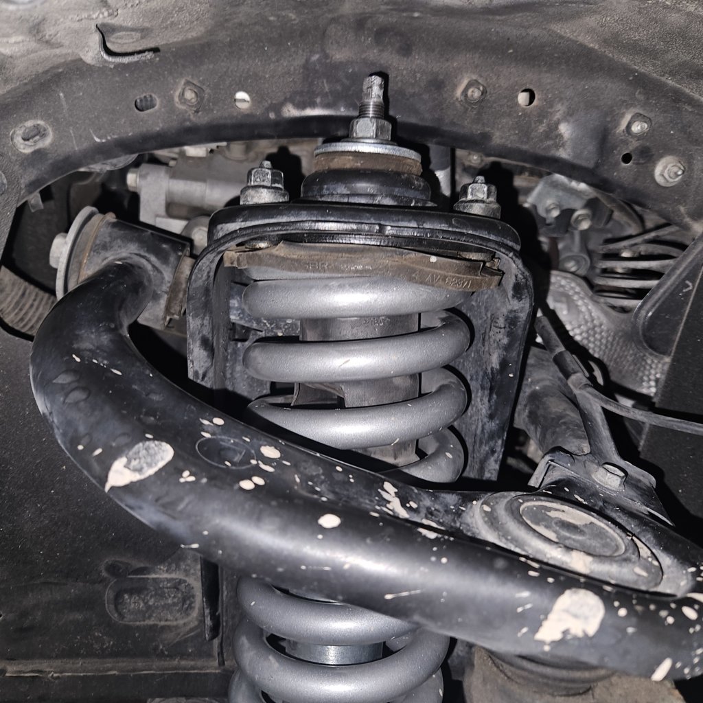

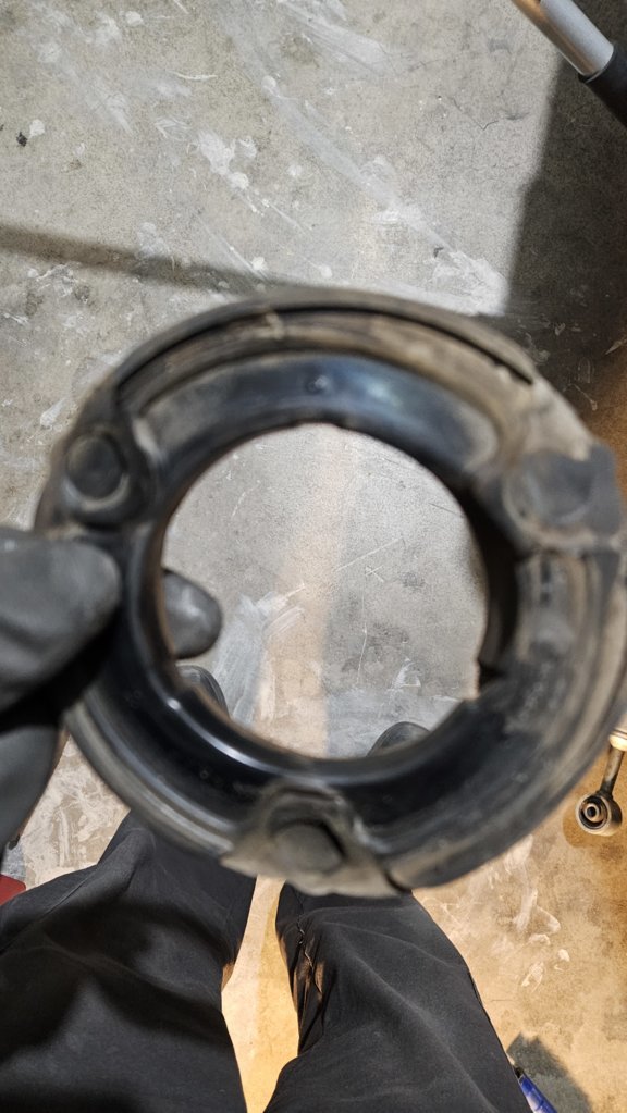

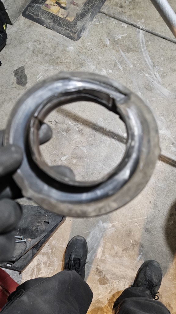

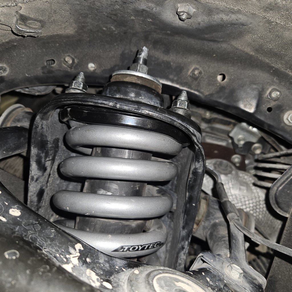

    Coil isolator and coilover bushing

    A replaced isolator will bring back 1/4"+ of front lift from the old squished rubber.

    I left the isolators in when I changed shocks because they looked "ok". 3 years later I swapped them out with the coil springs. Wish I'd done the isolators first time through. Just the ride improvement compared to old half worn out isolators made it worth changing them not counting restoring some of that sag as you mentioned.
