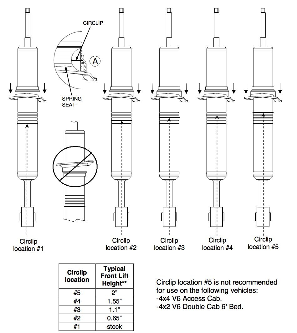

    Bilstein 5100 second from bottom clip setting will net you 0.65 front lift, giving you close to 1/2" rake FB_IMG_1675620501800.jpg

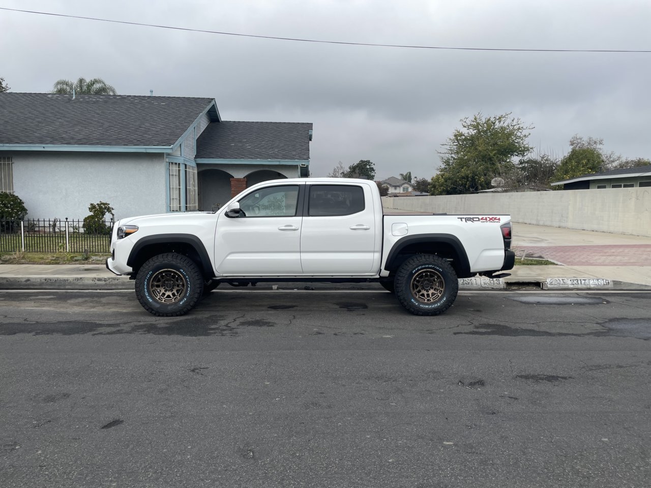

    As said above measure yours when you get it before deciding how much you want to lift the front. The Pro comes an inch higher in the front from the factory and that's pretty damn level. Everyone telling you to only go a half inch are honestly just wasting time, it's barely noticeable.
    And as far as hauling, most folks don't buy a little Tacoma to haul stuff daily...other than a permanent RTT or shitload of broverlander gear. 99% of the time the only thing I'm hauling is my old ass.
    That's 2" up front and it's balls on level as measured above.
    DavesTaco68 likes this.

    Damn that looks good
    Can’t wait to get the Cestrial Silver Taco
    Lots of good advice, just in planning stages and getting opinions.

    1.1" up front with Bilstein 5100's is the correct answer.
    Bigger better shock than the OEM shocks, and Bilstein recommends you keep the OEM springs. No brainer...

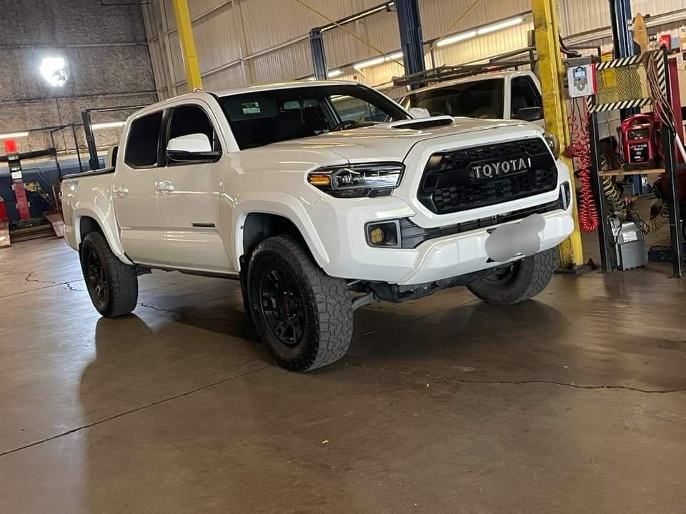

    Cool stuff
    6112/5160 set at .5 lift
    no rear lift
