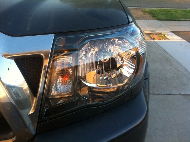

    I just noticed this the other day. seems like the the little light in beside the headlight, its a little yellowish/oranish color has melted. anyone had this issue.

    Very common problem. Take it to the dealership and have them replace the headlight assembly.

    Extended warranty on this so get to the dealer soon and get them replaced for free.

    Thank you all for your help. I went to the dealer with the tsb and they replaced both head lamps.
