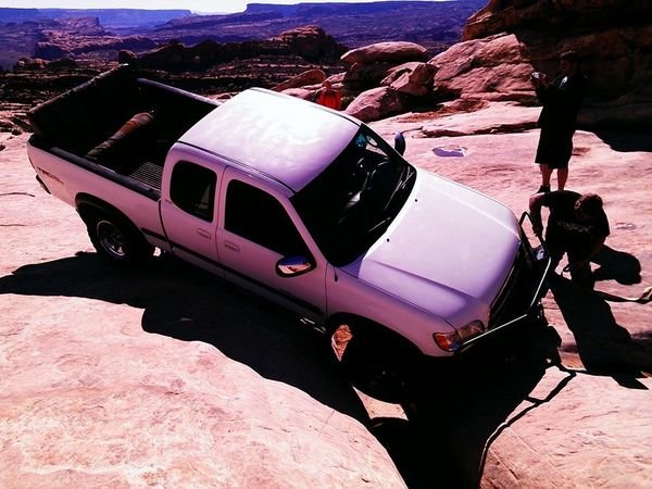

    A front locker is almost a must for real crawling like Moab. Invariably, one or two wheels will be off the ground and only a locker will keep you moving forward. the only issues I had with an ARB on my 1st gen Tundra were the weak axles. I broke three front axles in Moab with the ARB because the axles were undersized. My biggest question is, can these axles handle a front locker?

    Good to hear. I didn't begin breaking axles until I added 33" tires and an ARB and started wheeling Moab; which I plan to do with this one also. Still, an LSD is not a locker.

    You could do most of Moab with your current setup. Multiple lockers are only needed for the more extreme obstacles; and most have bypasses.
    My 2000 Tundra could not handle the Golden Crack without a locker. I simply won't wheel Moab without a locker. I agree, a front locker makes all the difference.
