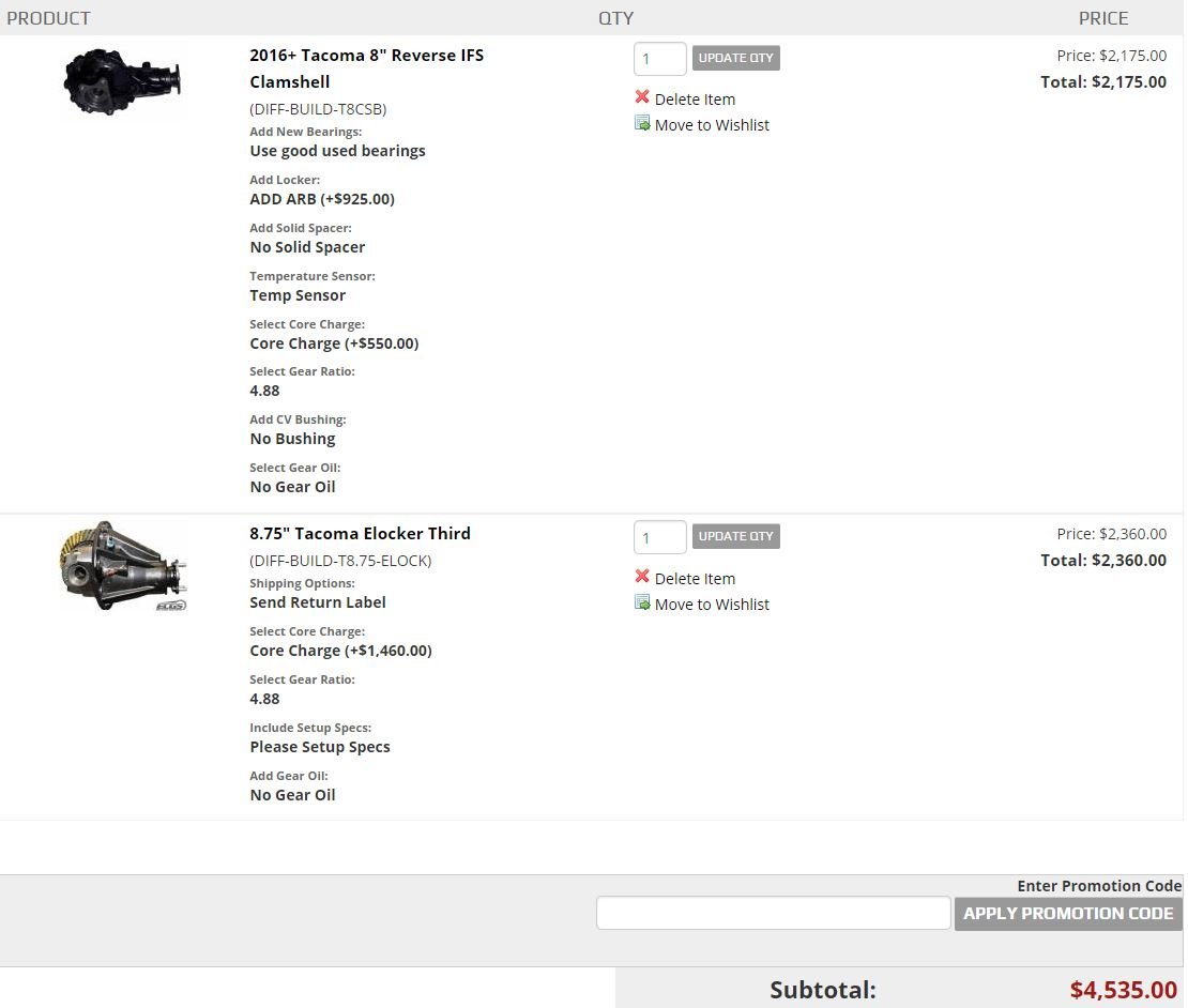

    I ordered the pre-built units from ECGS. Extremely satasfied with the purchase. Ever considered going that route? Also, for the speedo calibration, the re-gear shouldn't mess with the speed. Tire size does, and that's corrected by the speedo calibrator, but don't bother programing the gear size because that will throw everything off. :rofl:

    Yea the speedo calibrator is because I have bigger tires

    So you can custom build a 3rd member online and have it shipped to you?
