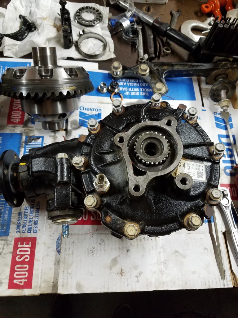

    I have a video that relates to this conversation. My buddy Fred bought pre-installed ARB lockers by East Coast Gear Supply and we installed them for him. The video below shows how we pulled the front diff and swapped it for the ARB one. One helpful tip that was offered by one of our subscribers was to disconnect the driver side motor mount, jack up the engine a bit to give yourself more room to get the differential out and back in. It's really tight to get out so I would definitely recommend trying out this trick to make the job easier. The other hurdle was getting the intermediate shaft out and swapped over. I wanted to use my slide hammer puller to get it out but the arms of my puller were too wide to fit between the gear and the housing. My friend Mikey said Harbor Freight sells a puller with skinny enough arms to fit since he did this same job. I had to resort to pulling the diff apart further to get that shaft out.
    Here's the video. If you have any questions, just ask.
    <iframe width="560" height="315" src="https://www.youtube.com/embed/w_gPiDvh9v4" frameborder="0" allowfullscreen></iframe>
    And, if you were interested in upgrading your rear diff, here's a video showing how to do this as well.
    <iframe width="560" height="315" src="https://www.youtube.com/embed/ZMTbgY1xQKk" frameborder="0" allowfullscreen></iframe>

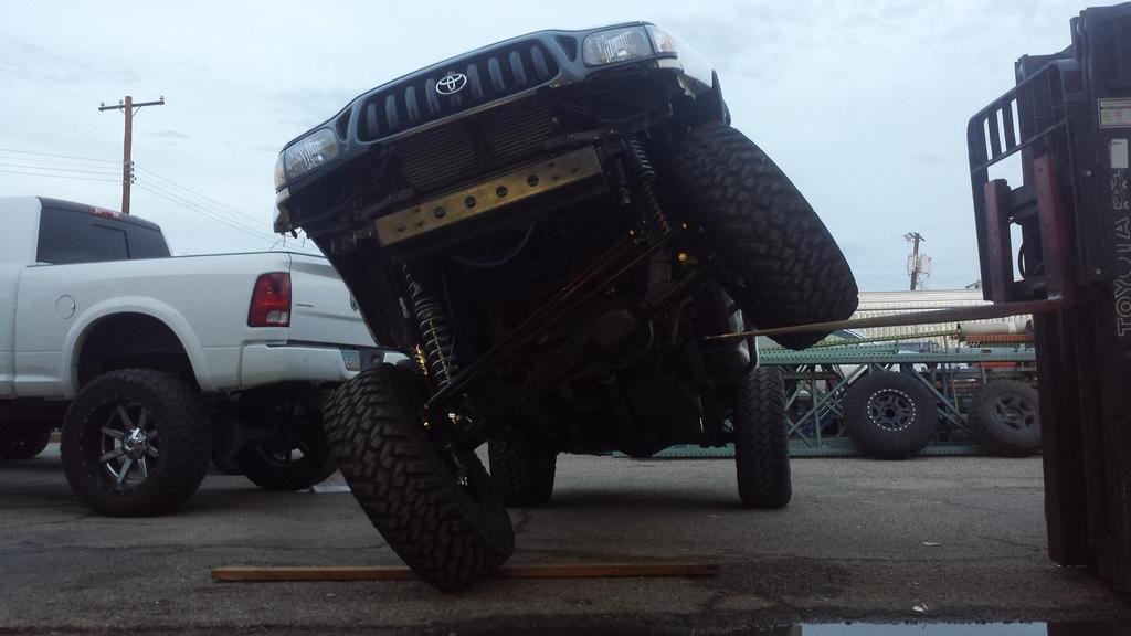

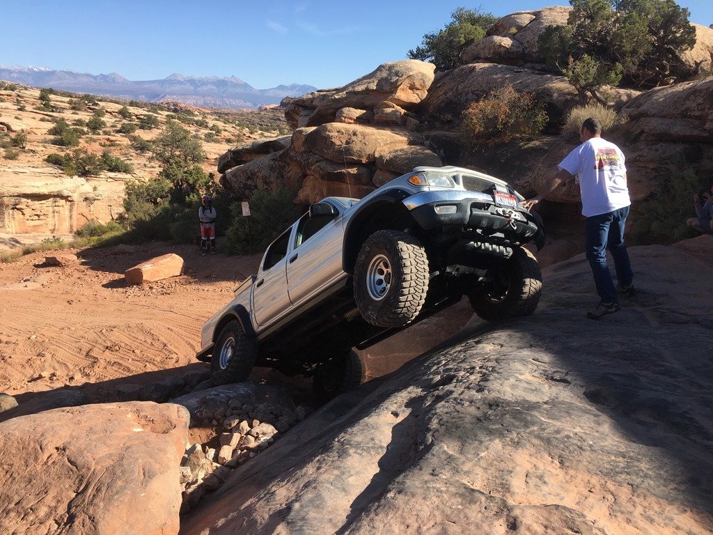

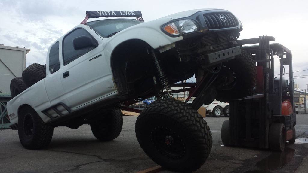

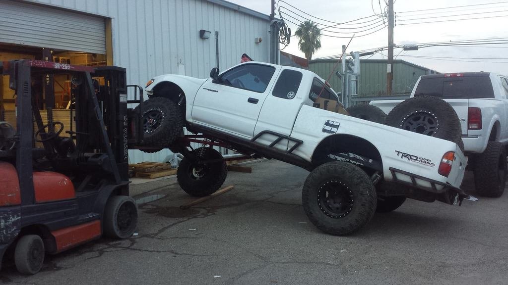

    I had an ARB airlocker in the front of my 01 tacoma with 33s. I got to the point where I could change out a CV in 12 minuets. I didn't mind this since I just bought 4 CVs from Oriellys so I could have two spares and Oriellys would replace them for free. I finally ended up blowing up the diff though. It was a toyota part so ARB wouldn't send me a new locker haha. Now Im just finishing up the SAS and about to do the rear suspension.
    I also pushed my truck places it never should have gone. So if your just getting it incase you get stuck it will be fine. If you plan on rock crawling and going places an IFS tacoma shouldn't be, then you will be blowing up CVs and eventually your diff.
