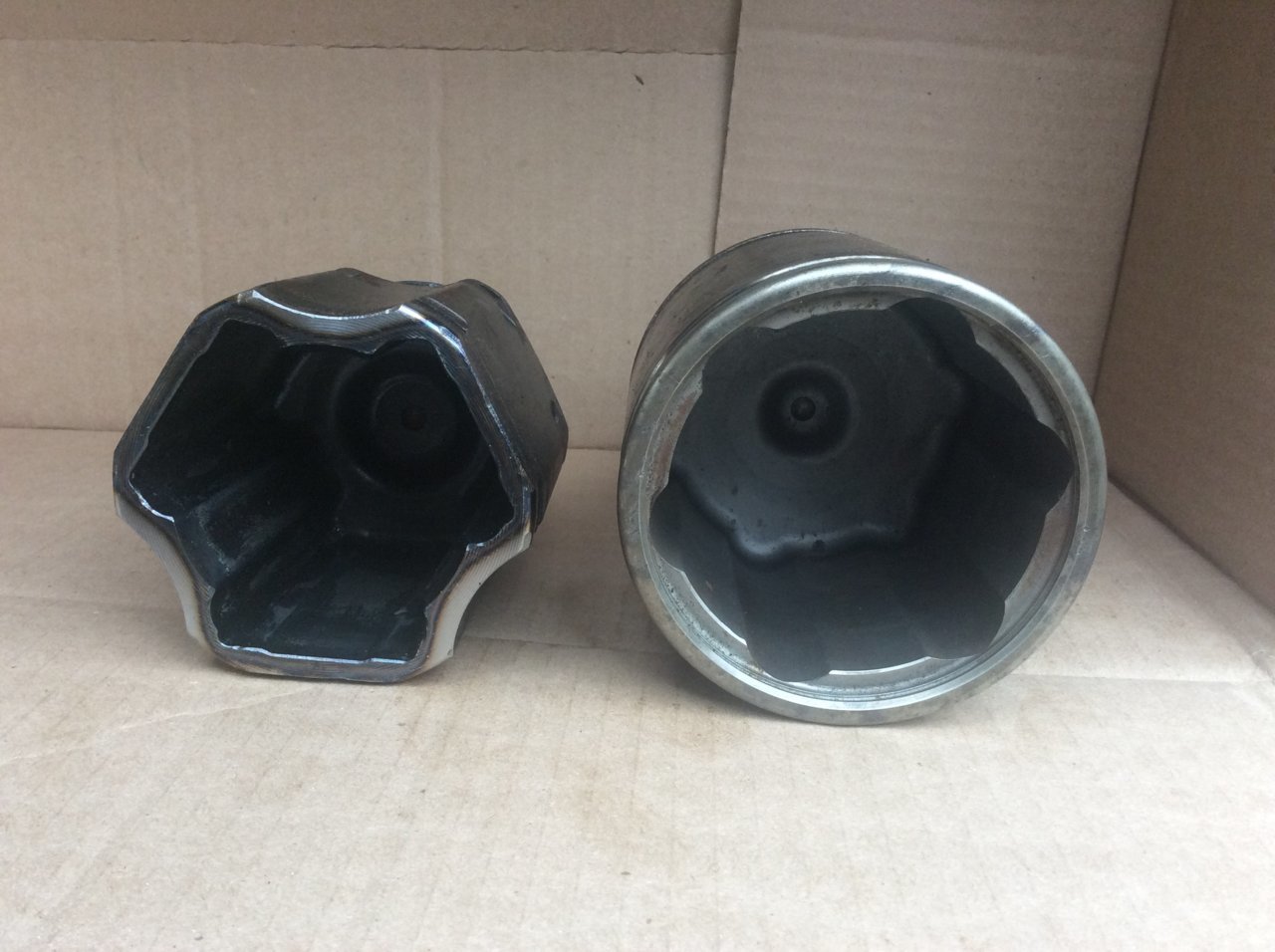

    I have a beefier inner CV, a 105mm UZJ100 Land Cruiser unit, the stub is 30 spline and it plugs right into the 8" diff. Need to figure out the shafts and outer joints.
