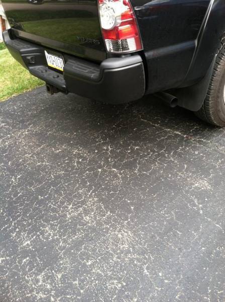

    I trimmed mine. I took a piece of metal placed it behind and traced. (Could use cardboard) Cut out the pattern. The bottom is not as wide as the top. So figure out a measurement that you want draw a straight line. Then use the pattern for the curve just do one side at a time. I used sheet metal snips and worked out good. I trimmed the backs just above the 4x4 as it was warn and did the front to match. Didn't document it but I'll look and see if I got some pics.
