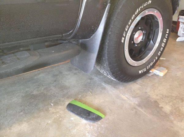

    Tin snips are what I used. Cut 3.5-4" off and used the bottom of the cut off piece as a template for the profile of the 'new' bottom edge. A little sanding with a foam drywall block & voila. Done.

    That looks perfect Qball. I'm doing this ASAP. No sense in dropping 70$ on the husky's.

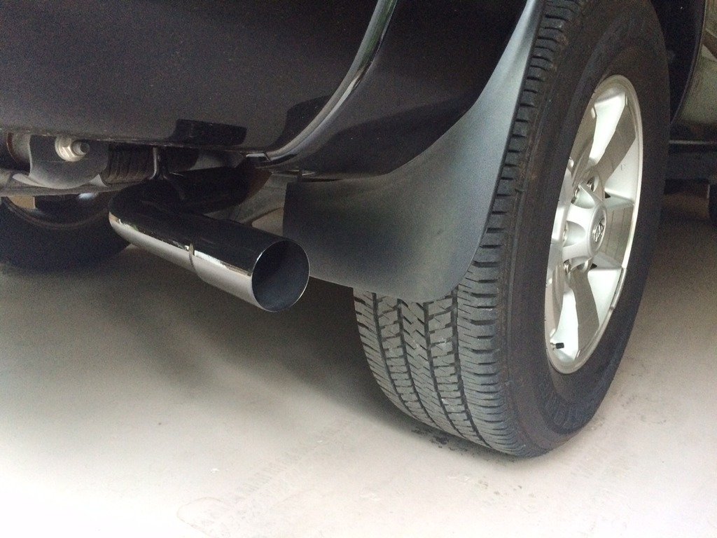

    I cut mine this weekend (while on the truck). Not sure how much I cut off. I came down 4.5" from the top. I let the truck sit in the direct sun while I made a cardboard template from bottom of the flap. I then penciled and cut with Tin Snips. The cut edge came out almost perfect. Just a very light sanding on the bottom edge. From 5 feet away, they look OE. Total job took less than 30 minutes. Oh yea, I hit that tail pipe with some black spray paint while I was at it...

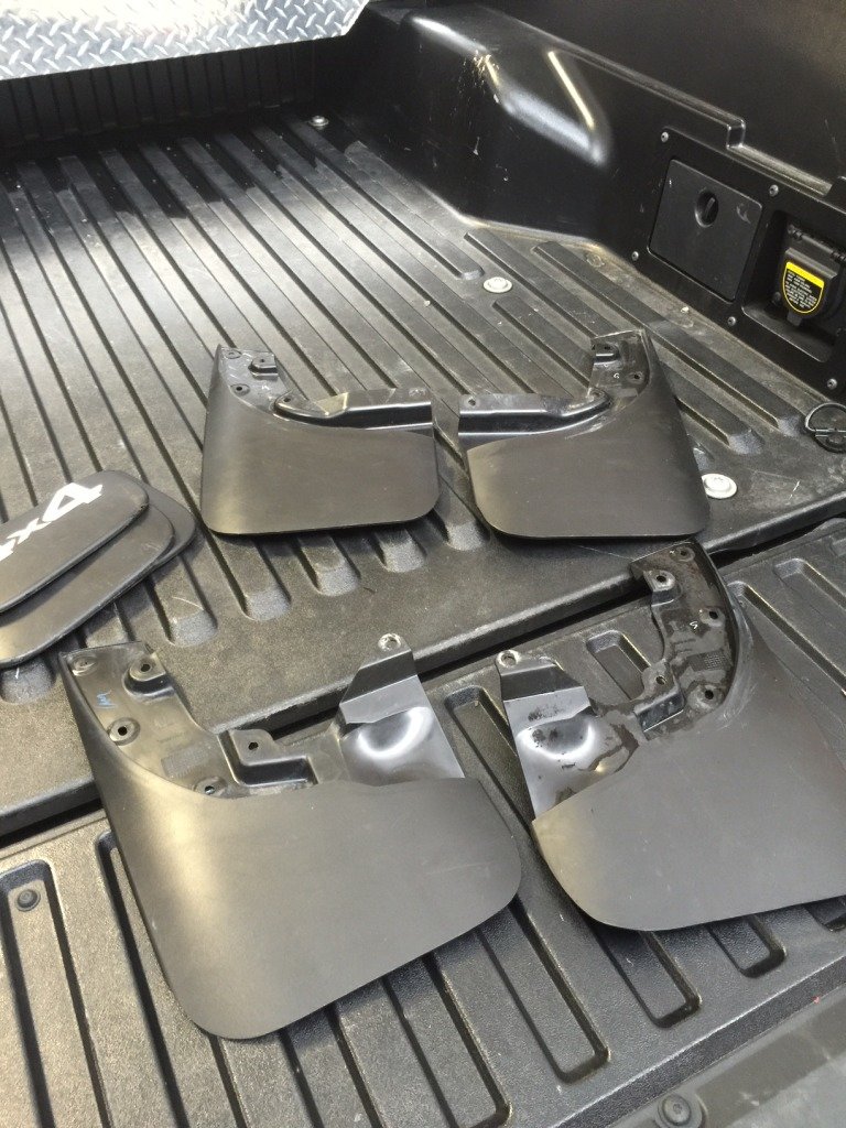

    I did mine this weekend as well. I took 5in. off the fronts and 4in. off the rears. I took mine off the truck and measured up from the bottom. I used sheet metal scissors and it worked great.
