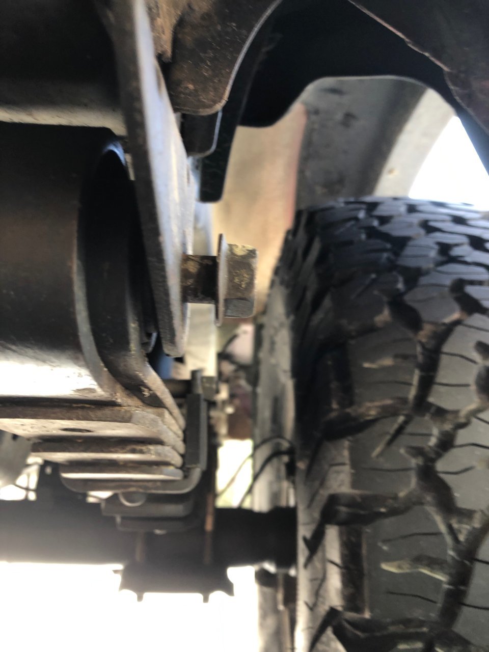

    Both of my nuts are missing. ;-) The nuts are missing on both leaf springs. Unfortunately, I noticed this after driving 450 miles. Anyone know what nut size is needed? These are part of the OME package bought from Wheelers. Thanks!
    This doesn't look normal:

    Get some locknuts for them. :thumbsup:
    If they are the same size as a second gen, I can find the sizing for you.

    Damn son! You are one lucky fellow. Had those bolts come out, you would have had a wild ride!

    Here is what I used (2nd gen) from Fastenal.
    M14 x 1.5 nylon lock nuts

    You're also missing your washers.

    Someone forgot to tighten em...

    Yup! I just put new tires (295 75s whoohoo!) and was under checking my tire clearance when I luckily looked up and then when 'what the $&^@ ... ?!?!!?'

    It's a really easy job, replacing leaf springs.
    Make sure to torque to spec while the vehicle is on the ground and the suspension is loaded.

    Dab of blue loctite isn’t gonna hurt anything either. Pretty sure they’re M14.
