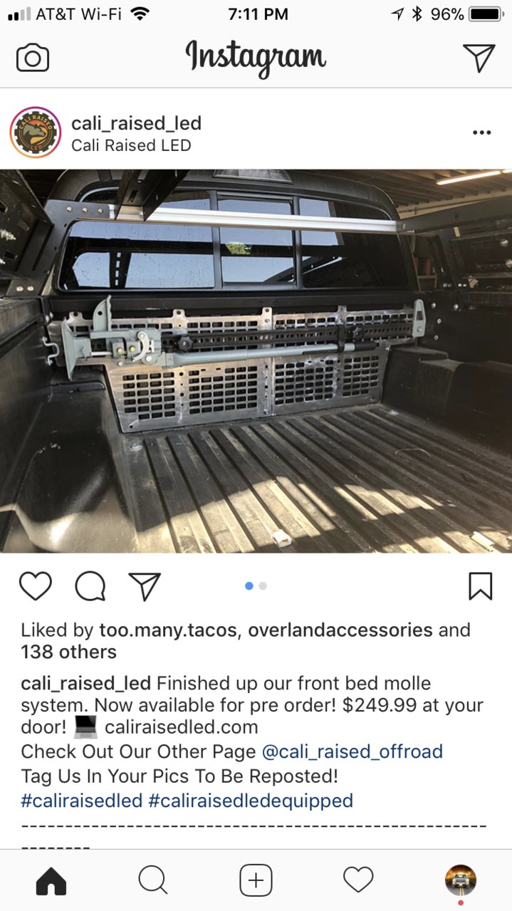

    Well... CaliRaised just posted their version on IG.

    I saw that, it looks like the only place that holds the their bracket is the 5-M6 or M8 bolts. The one I've designed use the bed bolts as well to provide stability and integrity. I also don't think it will cost $250

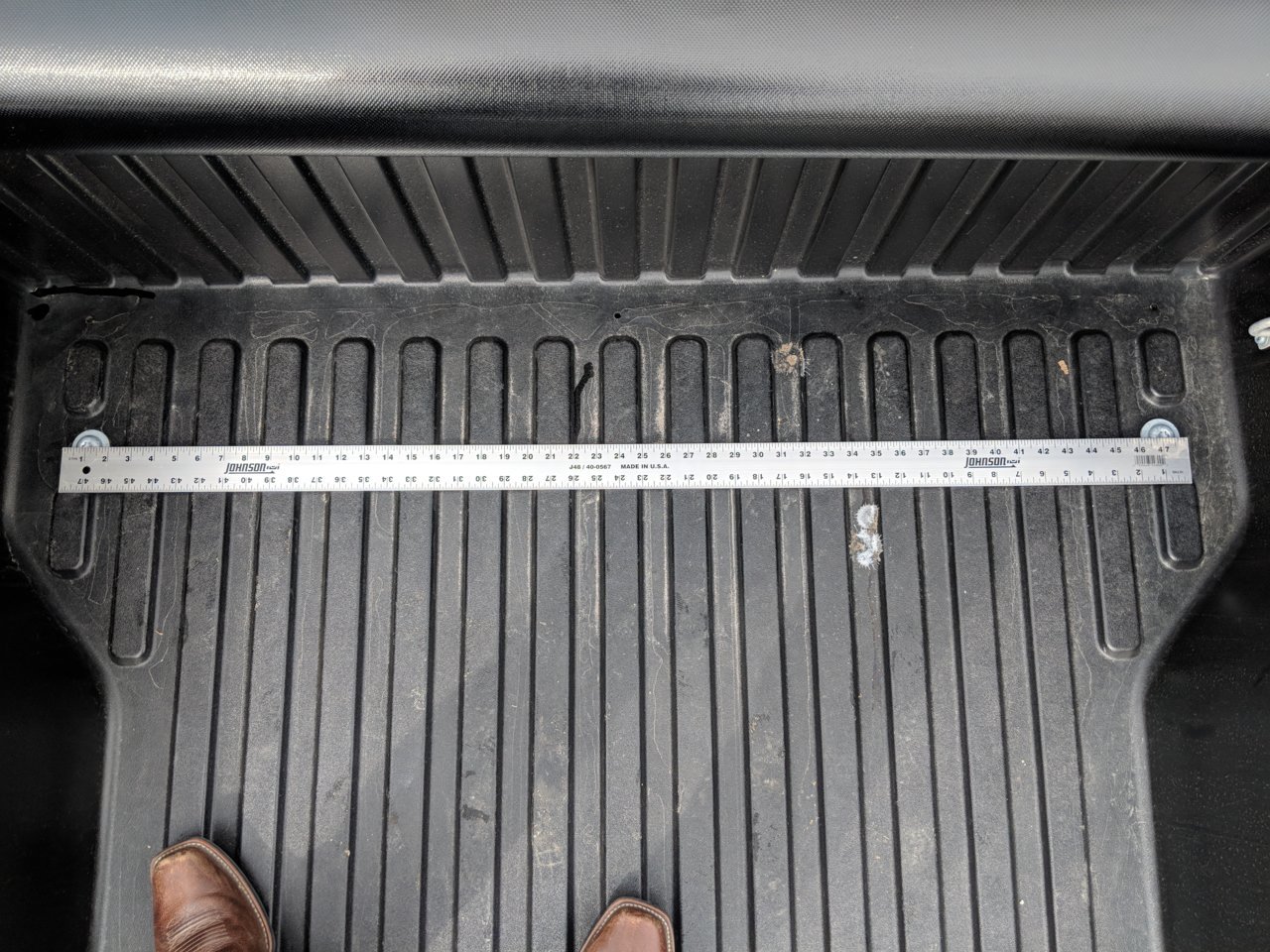

    For people who would like one of the for their short bed I need the dimension pictured below. It is the center to center space between the bed mounts; this is clearly going to be different for the short bed because it doesn't have room behind the wheel well like the long bed.
