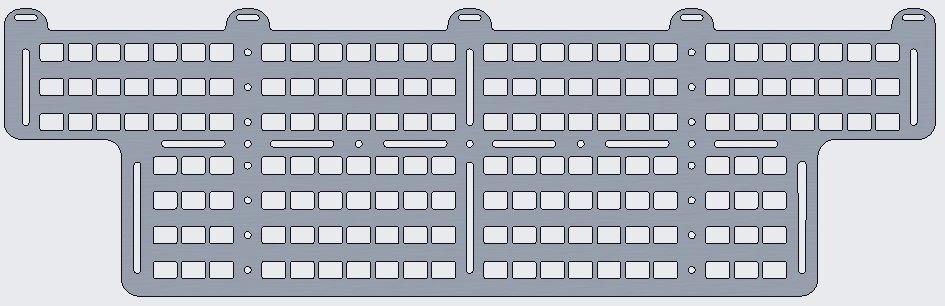

    Here is my first version for a short bed. Without knowing the bed mount hole spacing I can't add slots for that yet, but that's not difficult.

    So I've looked at shipping, material costs, nesting for laser cutting (or water jet cuts) and I think I could have either the short bed version or long bed version shipped throughout the US for roughly $150-$175. That's unpainted though, I think this maybe the way to go because it allows you to pick what color it is and if you even wanted painted. These prices are for either 3/16" or 1/4" 5052 Aluminum. I still need to talk with one of the fab shops about making these and there costs, but I have included my estimate for this in the price. I think the price from the fab shop will be lowest if I get more. Let me know what your guys' thoughts are; I will look into fab costs tomorrow. I've looked at shipping to Canada and that would add ~$50 to cost.

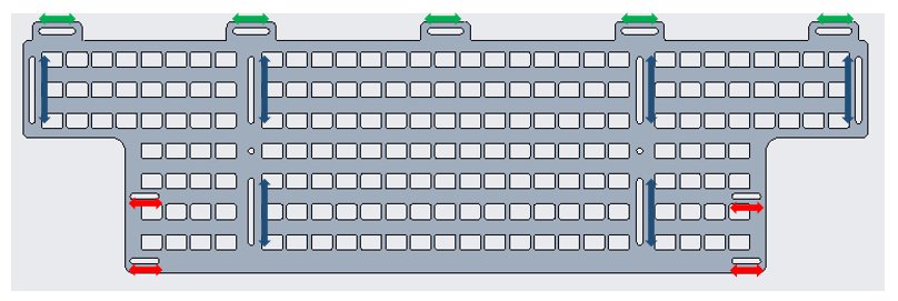

    These are the final models that will be available if enough interest is there.
    Long Bed Model:
    Short Bed Model:
    Rack Movement
    The slots marked with green arrows allow for side to side movement for top bed rail mounts.
    Slots marked with red arrows show the side to side movement allowed for the support brackets.
    Blue arrows are for slots used with bumpers and accessories.

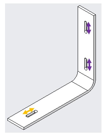

    Support Bracket Movement
    The purple arrows show how support bracket can move up and down.
    Orange arrow shows how support bracket can move from front to rear of bed.
