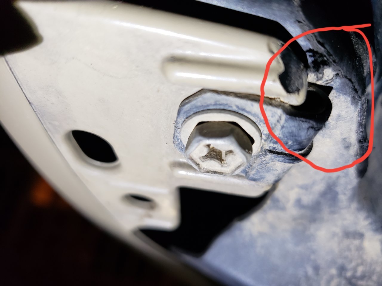

    I need to trim the front of my front fender liners/ bumper. It's right where the screw is that holds the corner of the bumper to the liner. It has that clip with threads for the screw. I need to cut back beyond the edge of the clip... probably beyond the bolt if I want to be thorough.
    What is your solution for cuts in that area. Looks like it still needs attachment for stability, just not sure of a good way.

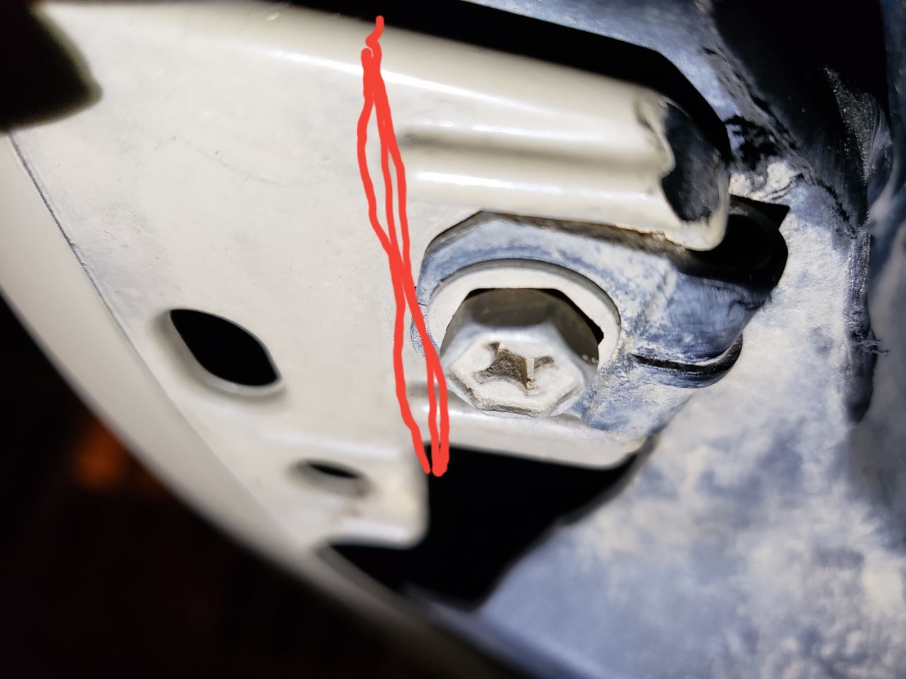

    remove bolt and clip follow lower line cut it off, I had todo this after I achieved 4* caster.

    Thank you. Just to make sure I understand....
    This is what's rubbing
    Is this the lower line you are saying to cut at?
    Thanks!

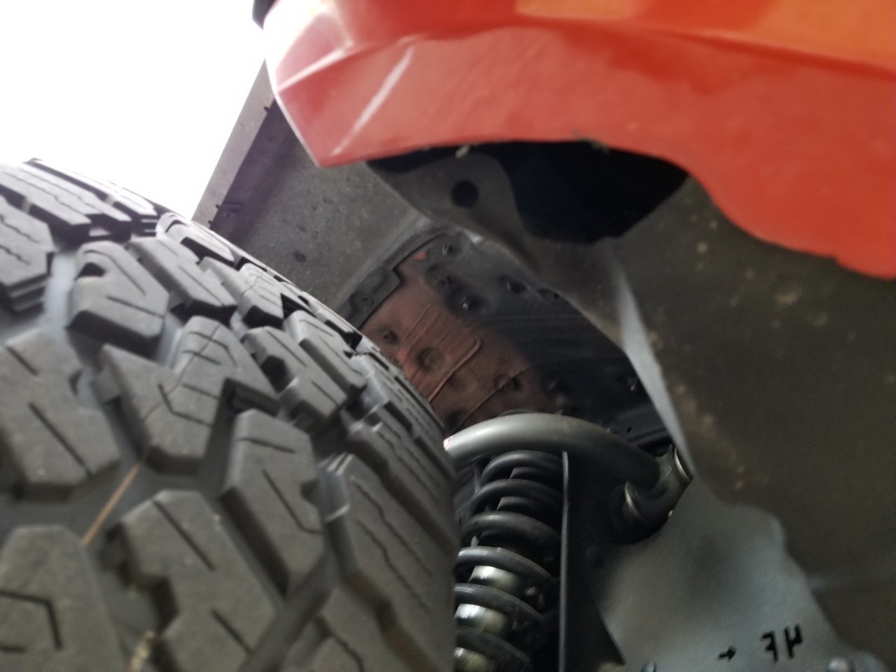

    here is a picture, also use a heat gun to move some of the liner back as well.
    ........and you can't even tell.
