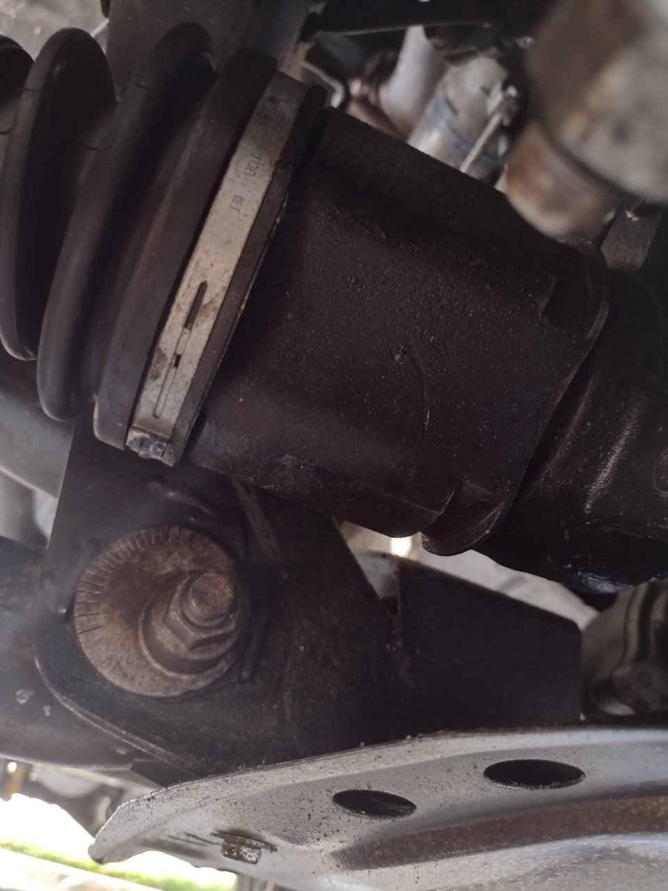

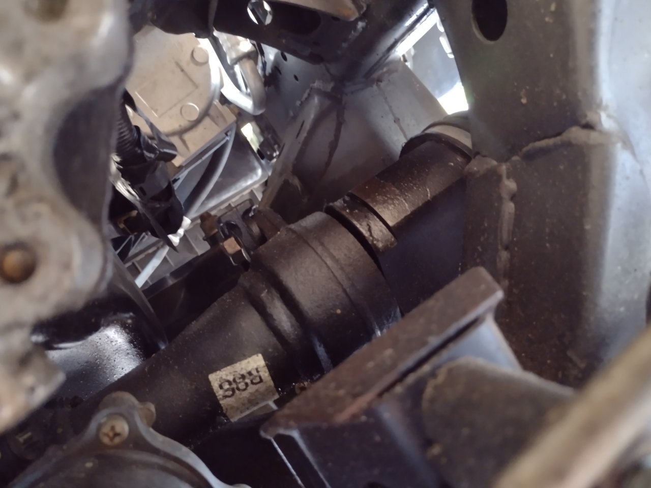

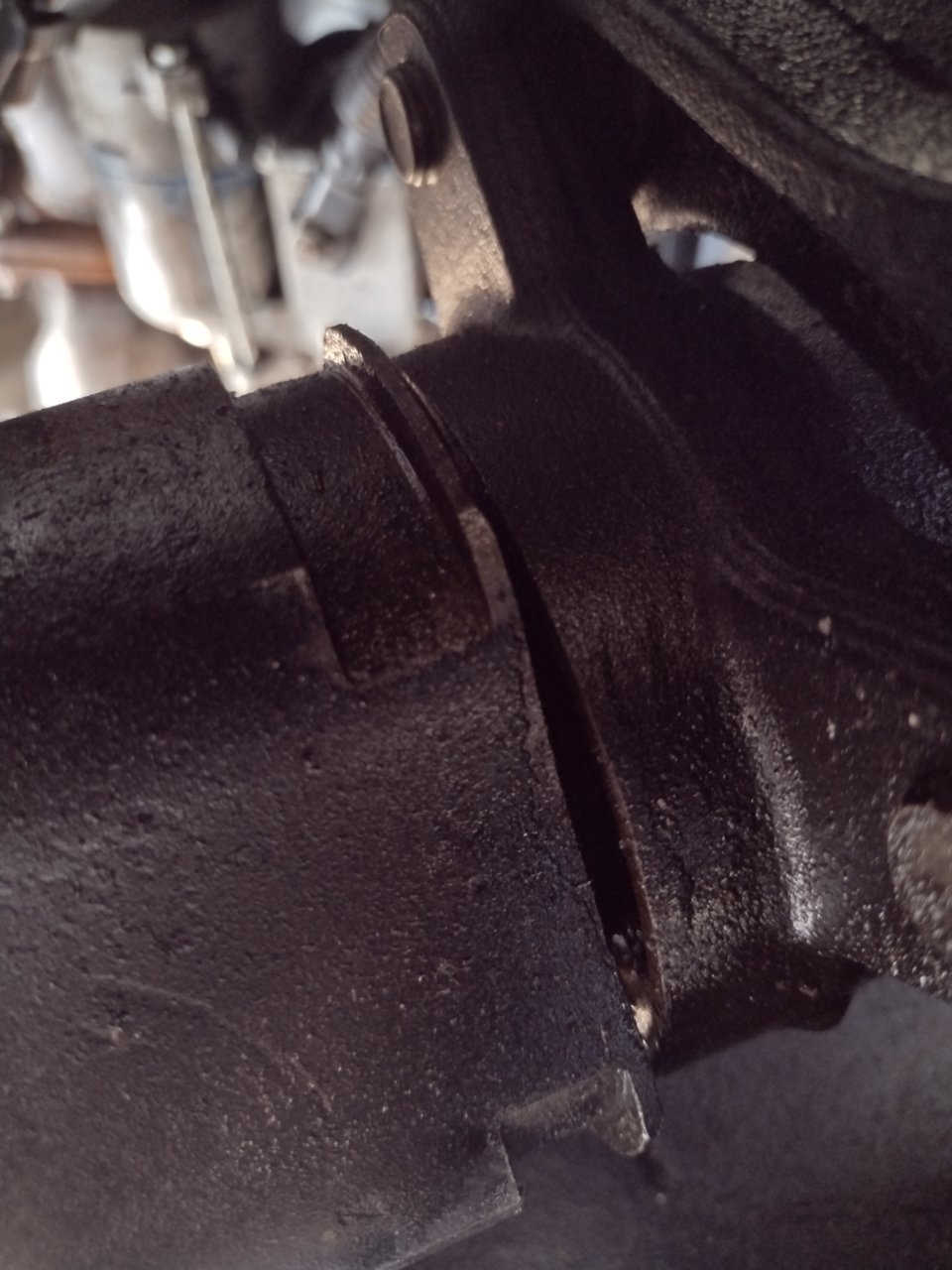

    Hey guys,
    I am trying to diagnose some road noise. I think it's a wheel bearing although I am not getting very much play when I lift the truck and jostle the wheel. I wanted to look at other possibilities before I order parts. I noticed where my front passenger (which is the side I believe the noise is coming from) CV axle connects to the tranny looks..odd to me? I took some pictures and you can see where there is a gap. I want to know if this is normal..there is some 1 to 6 play in this CV axle on the side far from the tire.
    4x4, 3.4L, 5 M/T
    Thank you!IMG_20230518_081615175_HDR.jpg IMG_20230518_081615175_HDR.jpg IMG_20230518_081623314_HDR.jpg

    That gap is normal. The end of the shaft where it goes into the differential has a cerclip that will snap into place when you push the axle in. There will actually be some back on forth movement (not much). Road noises could be many things and wheel bearings usually make a howl. If your CV axles are spinning all the time it could come from the diff bearing but that's just a guess as well. Good luck!
