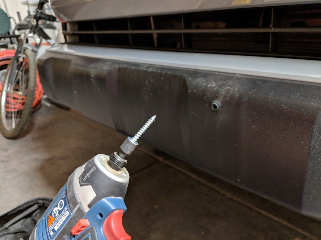

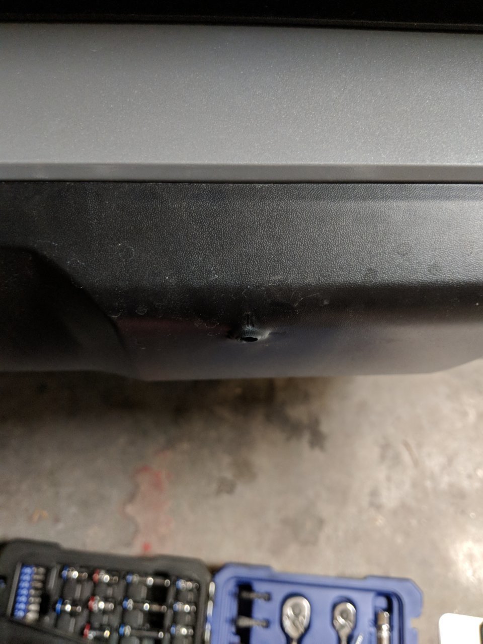

    Do you guys think these holes are repairable?
    I removed the license plate holder from the dealer and found some decent sized holes under it. Even if I were able to patch the holes well I'm concerned about having two shades of black contrasting there.

    You can try a couple of those Christmas Tree Push Plugs, while not perfect they are better than holes.

    Two possible options other than leaving it like it is.
    1. Sand down the bulge and use a bondo patch, then lightly scuff the entire lower piece, thinner wipe and paint withsomething that will hold up.
    2. Find some black Allen key screws that fit, put them in and you’re done.

    +1 on plugs or nice looking cap screws--some things do not lend themselves to ideal repair, and a better solution is making them look like they are supposed to be there:

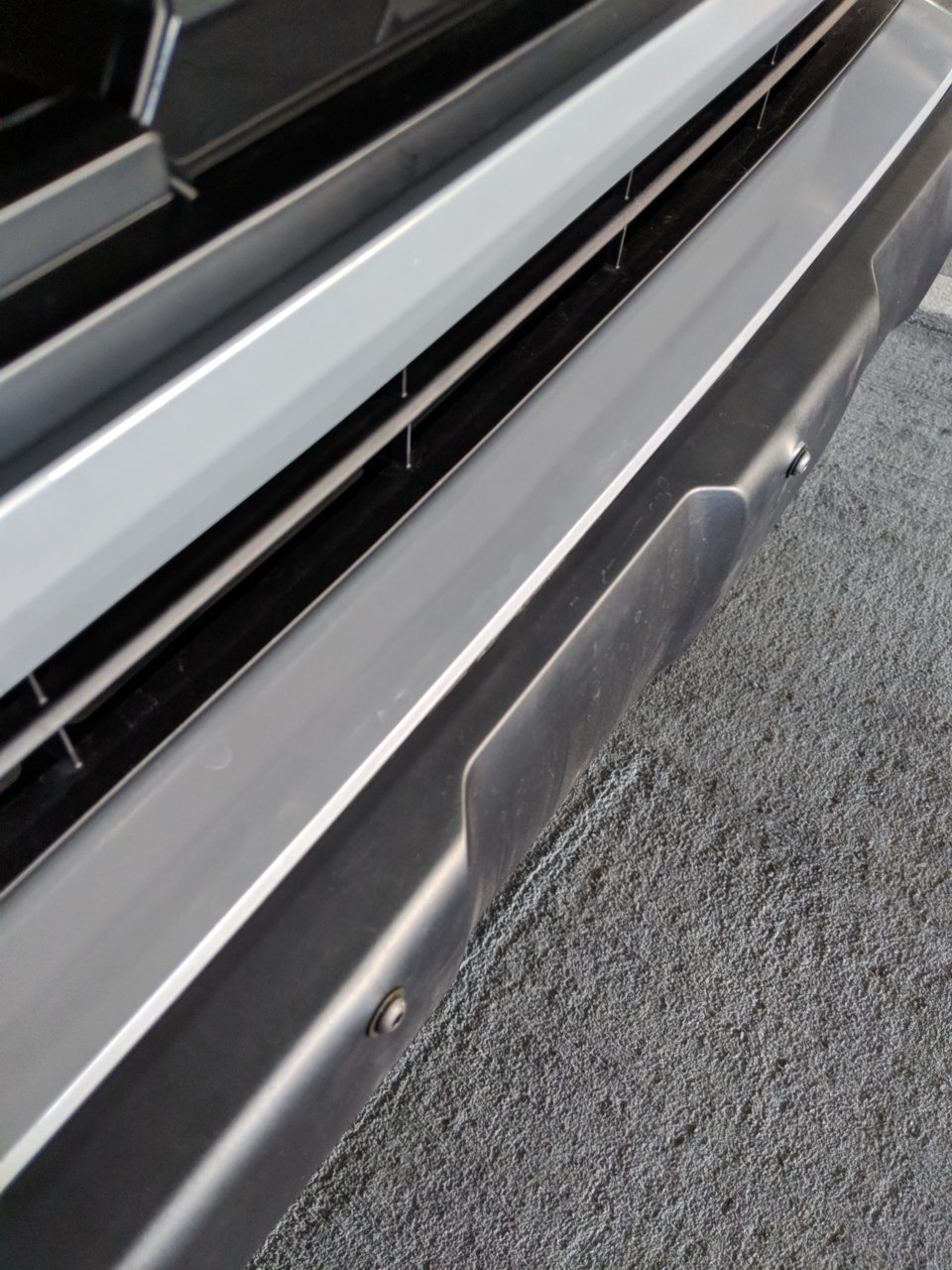

    Thanks for the idea.
    I had a hard time getting all the clips out and ended up breaking one so as long as it stays snug I think this fix is good enough to save $100+ and not buy a new one .

    Looks much better.
